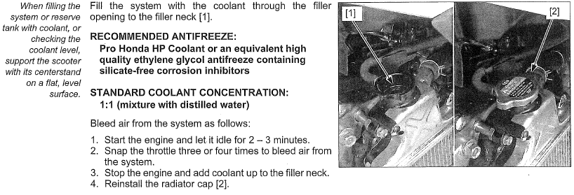

This is what my SM states:
bleeding air coolant.png (117.63 KiB) Viewed 2650 times
Last time I did it this way it worked out perfect. The first ride I took, I did carry some additional coolant under the seat - just in case. I had to add a little extra as the level went down again (so not fully bleeded by the SM procedure it seems).

Above SM is for 2013-2017 PCX version but I guess its the same for 2020 ;).

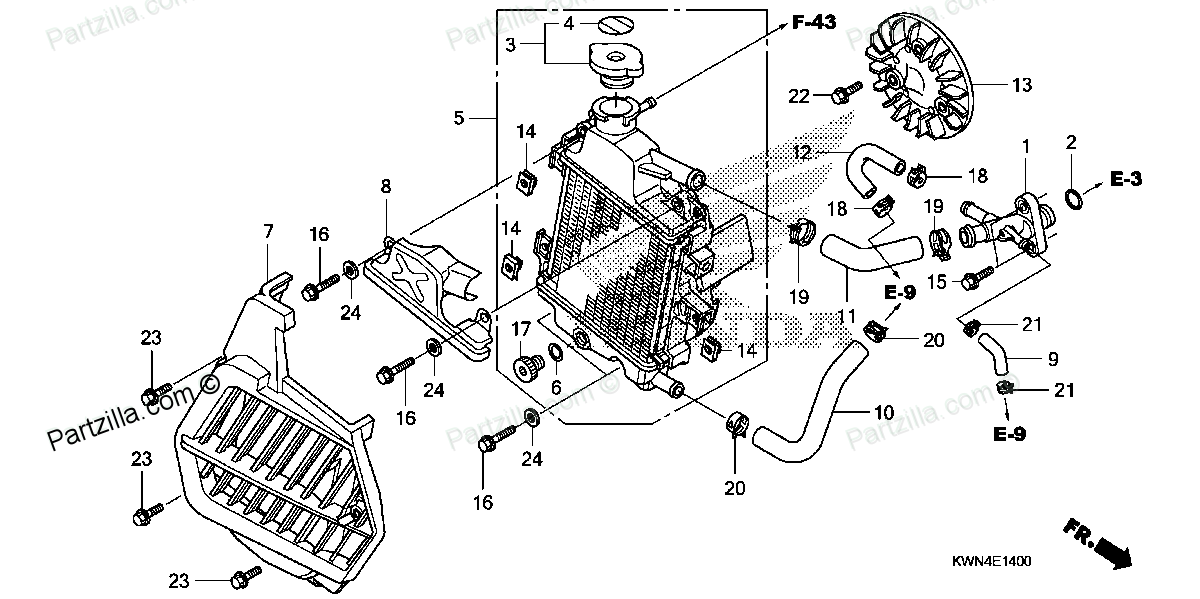

I also found a service manual online for PCX 2013 that shows this Image
Which I also notice at the top of the page on the old service manual
Butt,,, I guess you don’t really need to drain all of the old stuff out??
Good to see I can (probably) bleed with the radiator cap so thank you!
But I’m still not sure where to find the cylinder drain bolt on my 2020.
