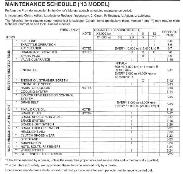

Just follow the maintenance schedule as suggested by the service manual:
maintenance schedule pcx.png (131.46 KiB) Viewed 1180 times
Also if its been standing a long time definitely check tires for wear and pressure.

I don't have the manual since I bought it second hand (should probably find a pdf online of it), that's really useful. Also, it's been standing for roughly 4 months, been standing on the center kickstand but the back tire has lost some pressure, should check the wear on the front tire as well.
According to the manual I shouldn't really be changing it... I believe changing it too often can also lead to some problems in the future, right?
