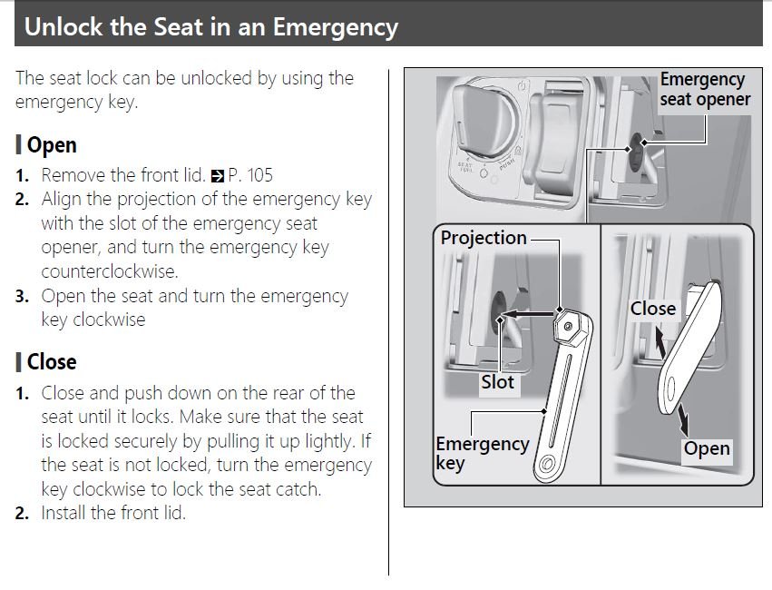

My PCX 2021 came with 2 emergency keys for opening the seat in case of a battery failure. See attached pic from owners manual page 137.
Unlock the Seat in an Emergency.JPG (100.16 KiB) Viewed 6307 times

Dwin wrote: Tue Apr 19, 2022 12:21 pm My PCX 2021 came with 2 emergency keys for opening the seat in case of a battery failure. See attached pic from owners manual page 137.
This is good info dwin. Thank you for posting it here.
