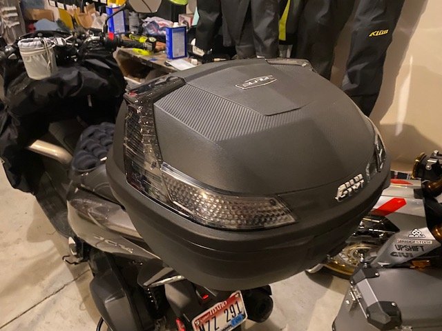

I got a Givi B37 Top case for my 2019 a few weeks ago. This is what I got:
https://www.revzilla.com/motorcycle/giv ... _id=914307
In an effort to increase my visibility from the rear, I decided to get the light kit for the box. In addition, I got a Skene IQ-260 Rear Lighting Controller so the lights on the top box would function as running lights and brake lights. This is the link for the controller:
https://www.skenelights.com/online-stor ... -p80153945
I have used Skene stuff before on my Africa Twin and I have always been very impressed.

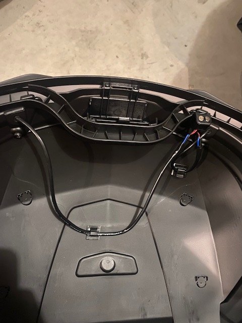

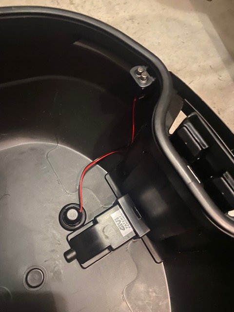

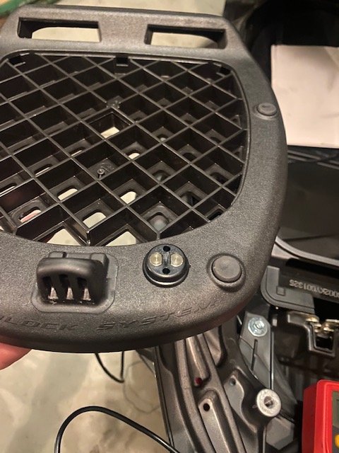

I started by Installing the lights and associated wiring on the box and the mounting plate.

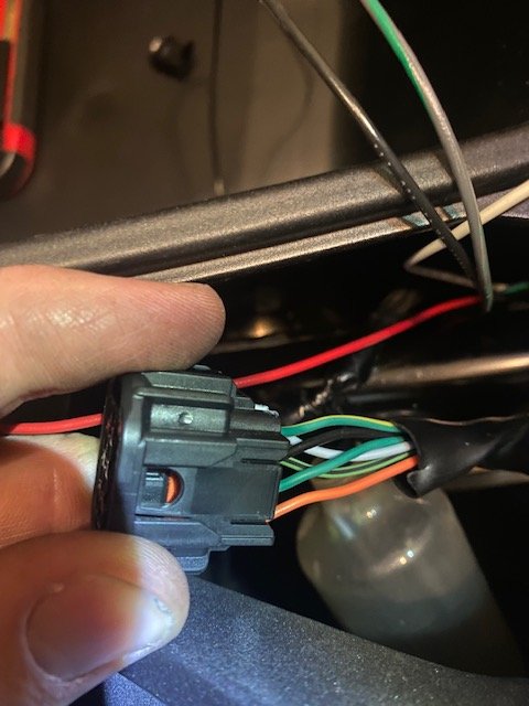

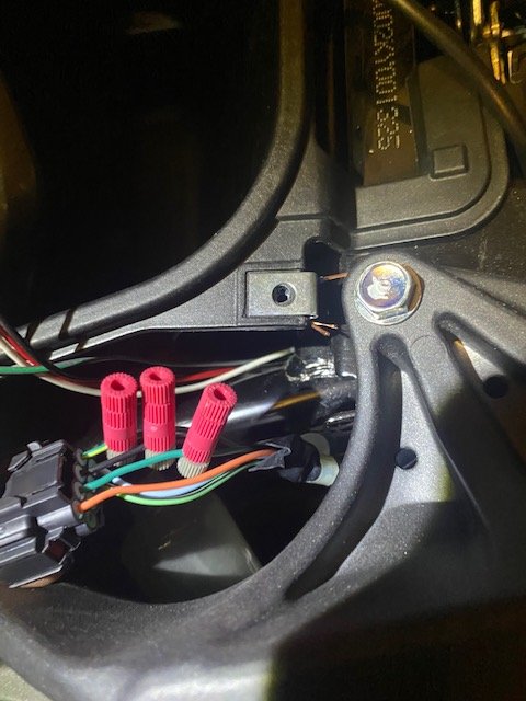

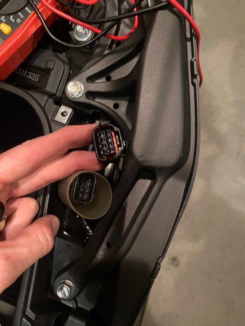

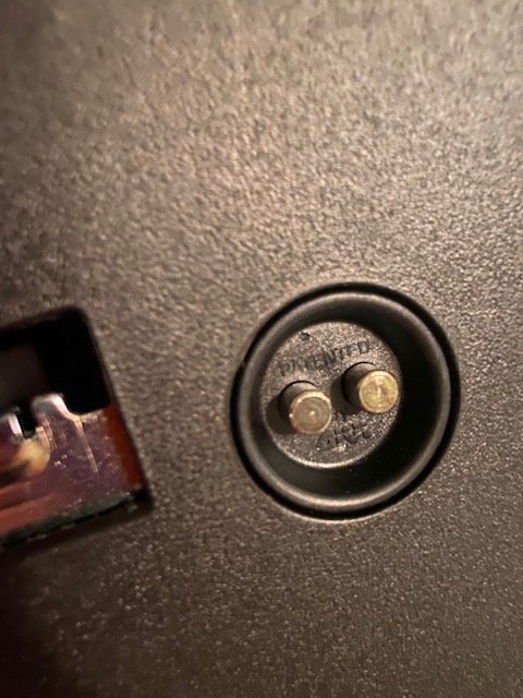

It's pretty neat because the light kit includes contacts that make a connection when installed but just pull apart so there aren't any wires to disconnect when I want to take the box off. After getting this done, I had to get the Skene controller wired up and installed. This required removing the top box mount and rear plastic cover to get to the taillight wires. The connector is on the left side of the scoot under the rear cover.

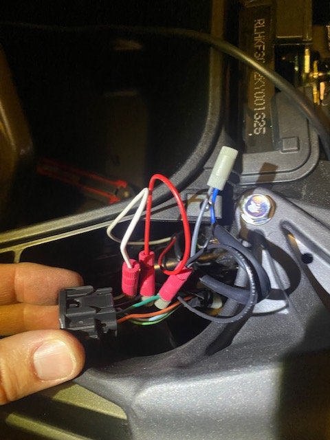

I used my multi-meter to figure out which wire is which. Solid green is the ground, black is the 12 v to the tail light, and green with a yellow stripe is the brake light. I used posi-taps to splice the wires from the light and the Skene into the existing wires.

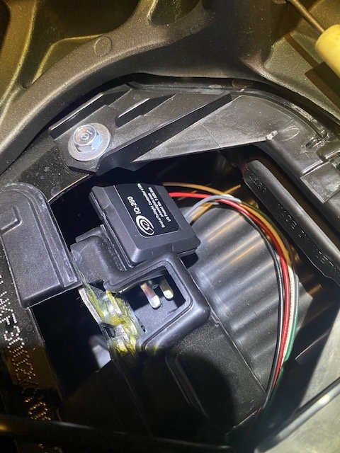

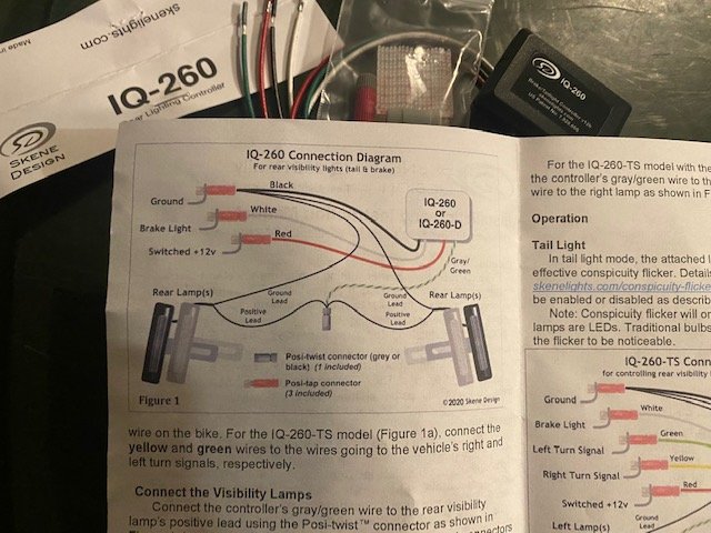

I wired it according to the diagram included with the Skene.
I then mounted the Skene next to the seat latch using the supplied duo-lock tape

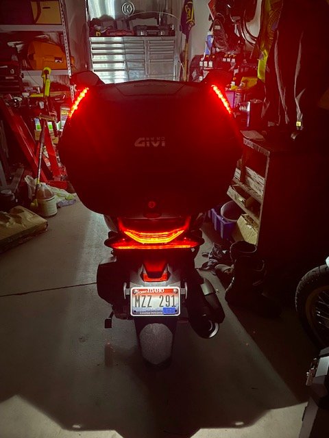

This is the finished product. The running lights are on all the time and then they get significantly brighter when I apply the brakes. The Skene includes three programmable brake light options but I haven't messed with them yet. I'm very happy with the install and feel really good having extra lights on the back of my scoot.

Nice!! I had my Givi box lights connected through their magnetic hookup but for some reason if I hit a bump in the road the connections would be broken. I also found that I could not connect additional lights through that connector. Eventually I pulled the connector and hooked everything through a quick connect. Not the cleanest hookup, but it is easy to disconnect when I need to take the box off, which is seldom. I have a much smaller box than you do, but your lights are so much better! Still, I am a believer in plenty of tail lights, so you have done well. 8)

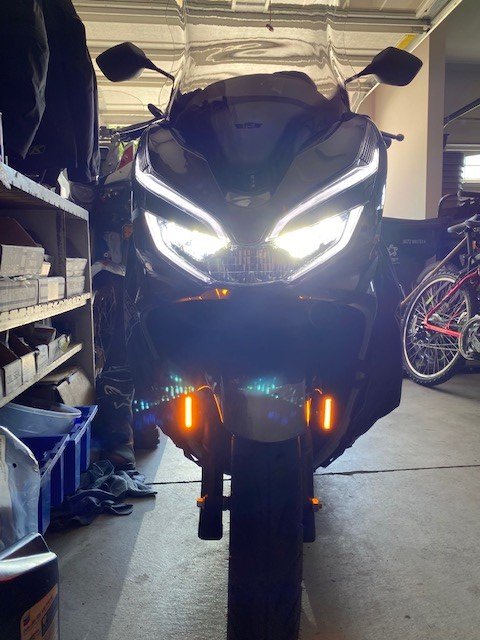

I also put Skene visibility lights on the front forks that have the flicker as well. Really makes me feel better to know I am more likely to be seen.

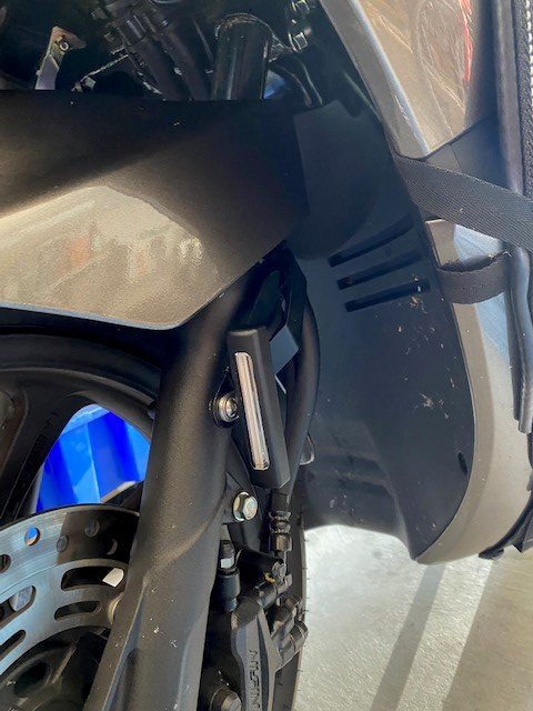

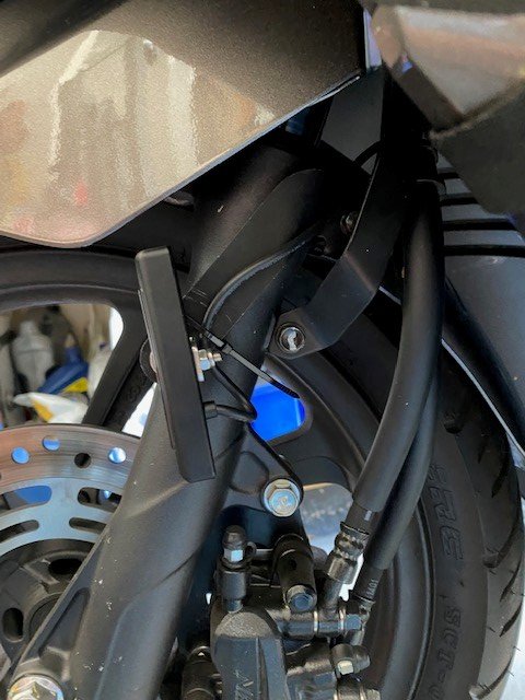

-I mounted the light to the reflector bracket that is already on the fork. I just removed the reflector and used the T1 front mount bracket. The holes in it were the perfect size.
Fork 3.jpg (69.82 KiB) Viewed 15242 times
Fork 4.jpg (73.21 KiB) Viewed 15242 times

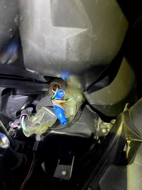

-I chose the Photon Blasters for a few reasons. They are very small and light weight and match the size of the scoot well. They do this flicker thing that makes them very noticeable, especially in peripheral vision. And the best thing, the current draw is VERY low. They didn't require a separate power wire and could just be tapped directly into the headlight power. I used a multimeter and test light to figure out which wire is which and used Posi-Taps to connect them.
Fork 2.jpg (63.12 KiB) Viewed 15242 times
As far as the Diode Dynamic light, I would also be a bit worried about mounting it under the headlight. Every bit of light will certainly help with cagers noticing you but I think the research says that having as much separation as possible between lights is a good thing. I think the best is to have them as far up and to the outside as possible. Then again, mine are down low and pretty close together, but we can't all be perfect ;) Good luck!
