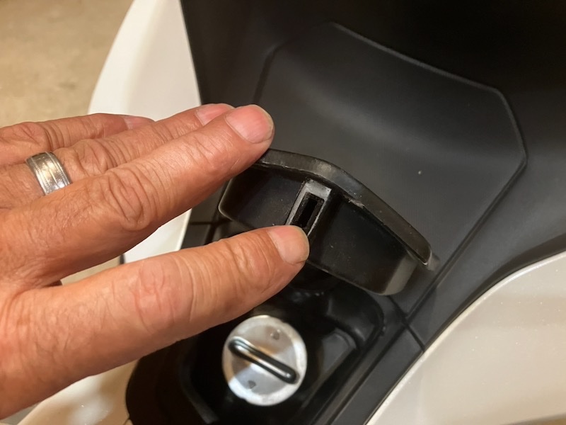

Posted: Sat May 25, 2024 3:40 pm
by C&K
The fuel door not opening when you press the rocker switch is not necessarily a problem with the latch proper. It's a problem with interference between the latch hole on the door and the mating piece it goes into. Press and hold the rocker switch and push the door closed several times and note where it binds at the latch receptacle. When the plastic warms up and expands it gets worse. Just take a mill file and file off a bit of the plastic where my finger is pointing at the hole in the door where the latch loop goes into, so it doesn't bind, and it will open every time. This is on a 2021, but it's the same as the earlier ones.
