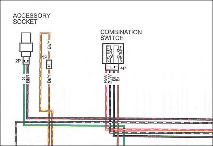

Hi
I am the proud owner of a bright yellow PCX150 that is the first scooter I've owned after 15 years of riding larger two wheeled beasts.
Unfortunately my scooter was almost stolen a few weeks ago and the ignition was cut.
The scooter is from 2017, but the ignition switch has 4 pins, not 2 like all the wiring diagrams I come across.
I've purchased a new connector as the old one was missing when I found the bike, but I'm not sure which wire is which.
The colours are black, black with white, brown and red with white.
Does anyone have an idea which wire goes to which pin on the connector?

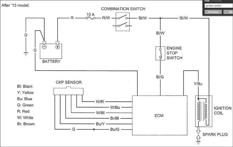

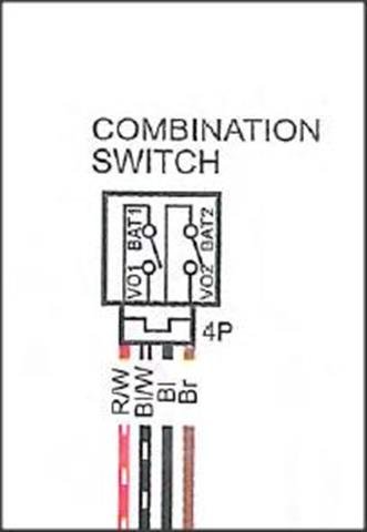

I checked the service manual. Honda seems to call the ignition switch a 'combination switch in the wiring diagrams. Here are some screen captures.

Thank you! This is really helpful!
This looks to be exactly what I'm after. I'll update once I've had a chance to review this with the bike.
