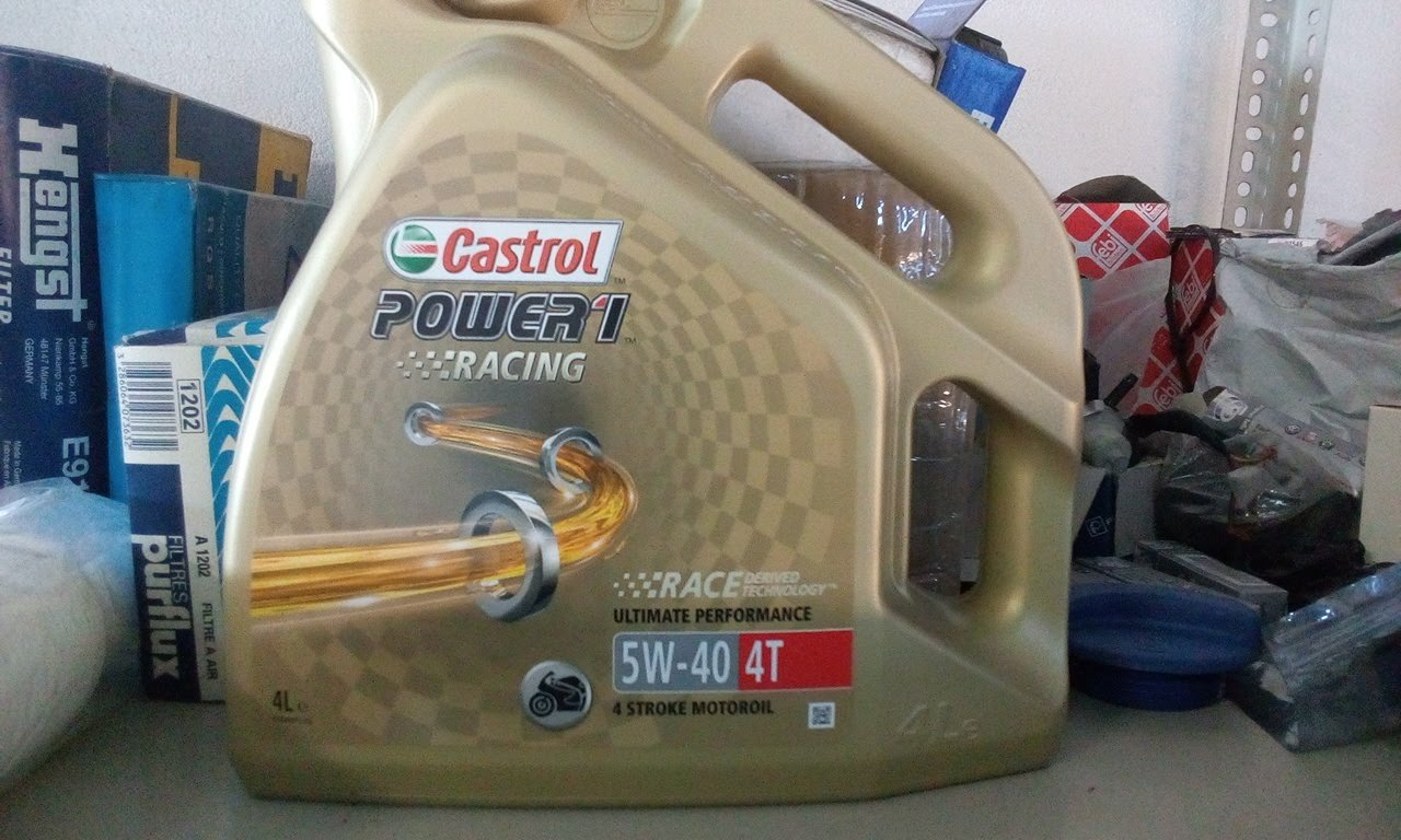

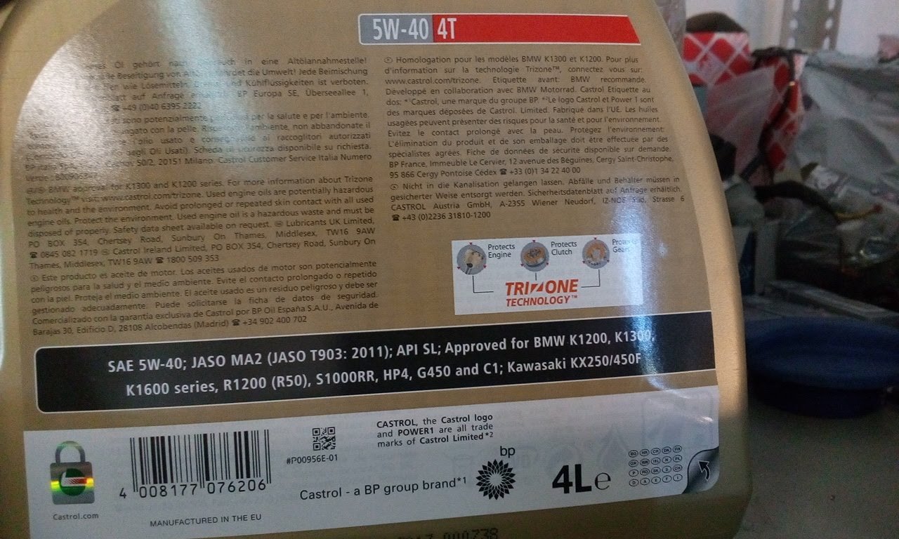

Good Morning. I have more than 50000 km done with Castrol racing 5w40 jaso ma2 and in the gearbox or gearbox (whatever you want to call it) valvulina Castrol 75w90, continues to walk every day 60 km a day at least ... and sometimes at speeds 140kh...
