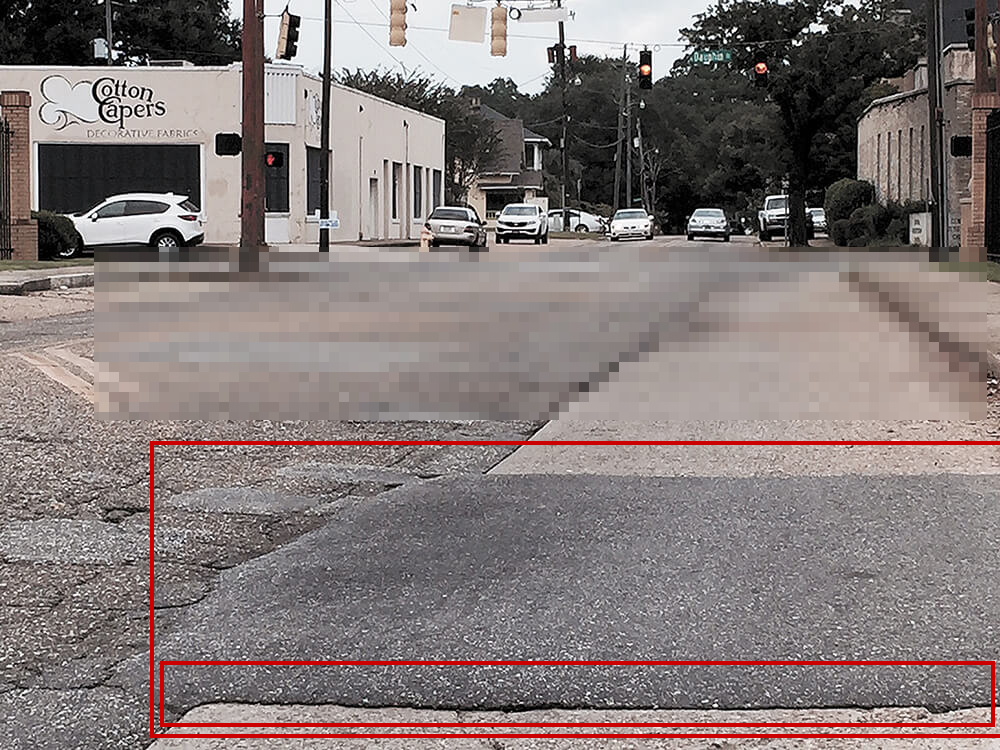

Here is a example of what typically can buck me off. I have highlighted it, notice the edge of the patch is slightly elevated...imagine that but more so around here, and also stretch that patch all the way across the lane...When I hit those at say 35 MPH it bucks me right off.
2020-11-02 16_49_12-Clipboard.png (1.22 MiB) Viewed 10872 times
