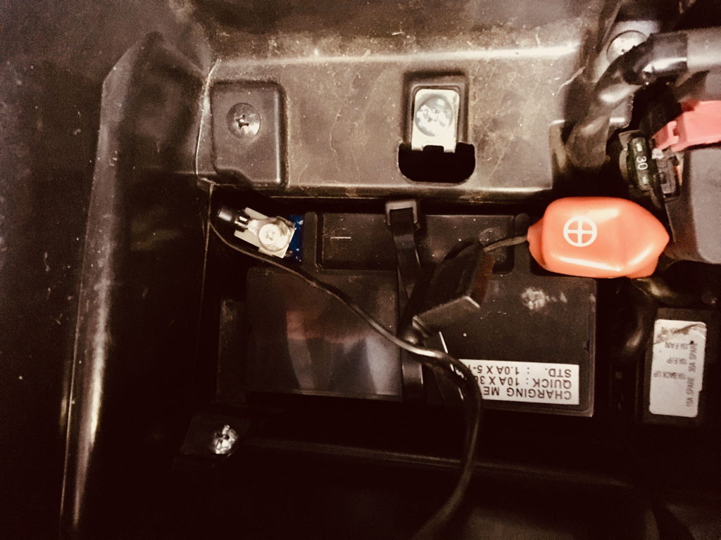

First, here are the leads (with fuse) attached to the battery:
1 leads and fuse on battery.jpeg (125.31 KiB) Viewed 8772 times

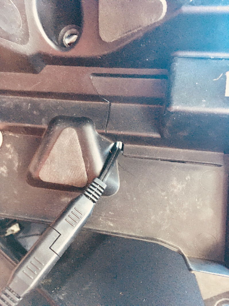

Now, here you can see where I cut a notch in the flip-up portion of the batter cover, and you can see the sort of connectors that came with my battery tender and with the extension I acquired.
2 notch in battery cover.jpeg (180.05 KiB) Viewed 8772 times

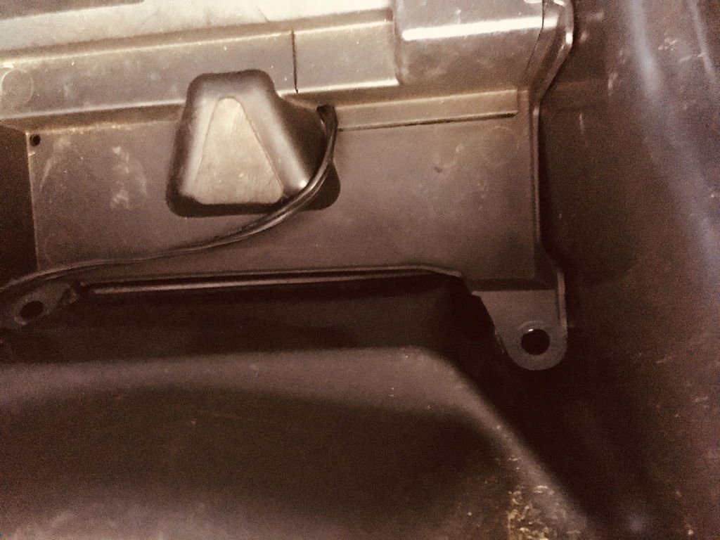

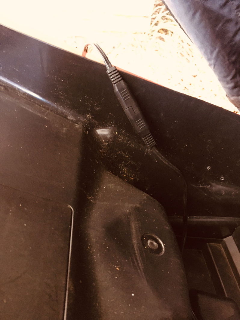

Here is the wire coming out from under the seat. There is a Thermoscud cover on the bike right now, but you can see daylight peeking at you from the other side of the Thermoscud.
5 lead out from under seat.jpeg (109.28 KiB) Viewed 8772 times

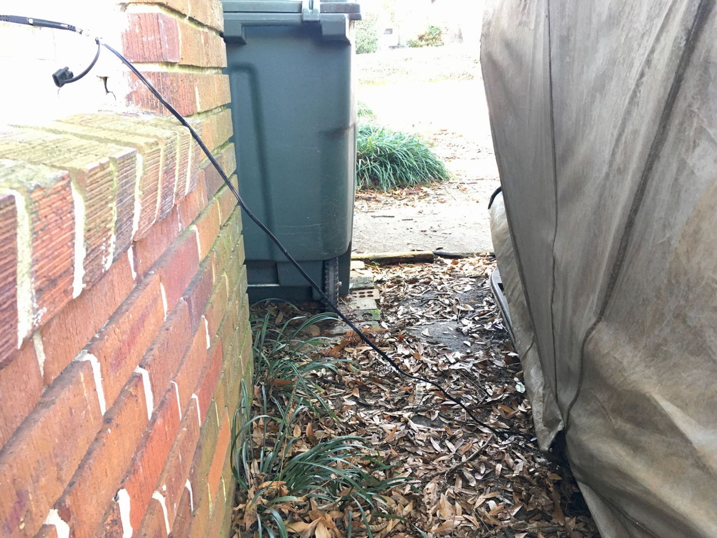

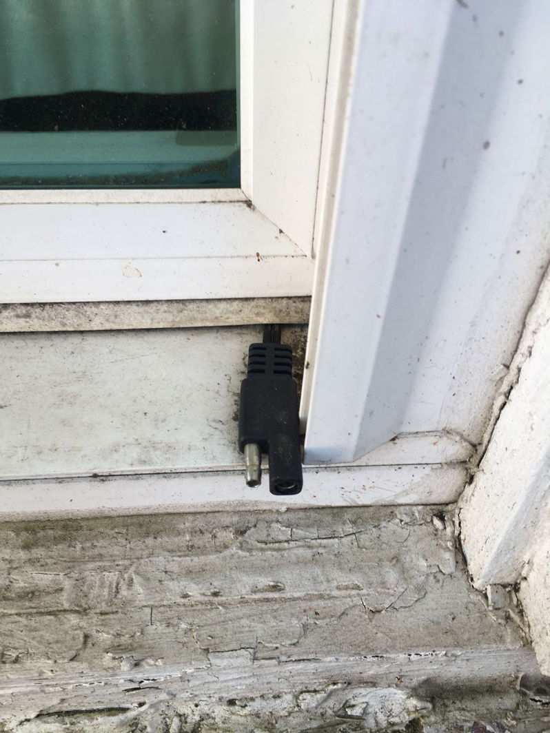

This is the lead from the charger that I leave sticking out from under the window. Yes, I know about all of the maintenance that needs to be done on the house here. Did I not mention all of the projects I am in the middle of? And this is the north side of the house, so just wait until you see all of the green growing onto the bricks that needs to be killed off. The window itself is a double-pane argon-filled thingy. This means that the wire has several permanent crimps in it, but it continues to work well after six years.
6 Lead out window.JPG (148.19 KiB) Viewed 8772 times

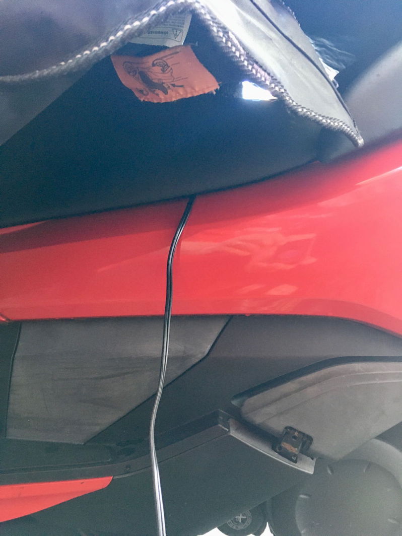

Here is what the wire looks like when the battery is charging and the bike is under its cover (a Cycle Shell). This is why I needed a long extension for my application. And, again, comments about all of the maintenance I need to do around the house will be ignored. I am well aware and have way too many tasks but far too little time on my hands.
7 Charging with cover on.jpeg (329.62 KiB) Viewed 8772 times

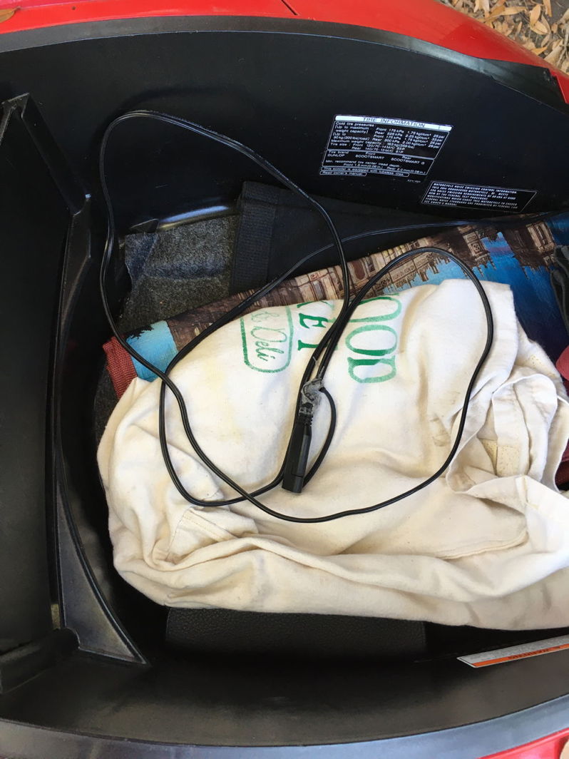

When I’m not charging the poor beast and just riding around, I simply cap that long wire and toss it under the seat (along with all of the shopping bags and sunglasses):
8 Lead under seat.JPG (136.09 KiB) Viewed 8772 times
