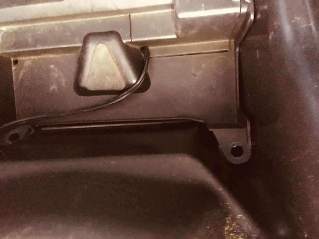

When I set the battery cover down and take out the slack on the wire, it looks like this:
3 lead coming out of batter cover.jpeg (134.95 KiB) Viewed 8759 times

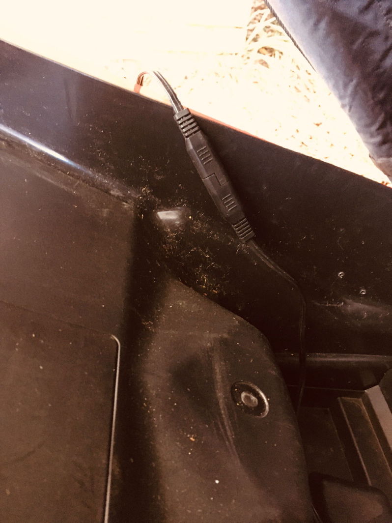

Here is the wire coming out from under the seat. There is a Thermoscud cover on the bike right now, but you can see daylight peeking at you from the other side of the Thermoscud.
5 lead out from under seat.jpeg (109.28 KiB) Viewed 8759 times

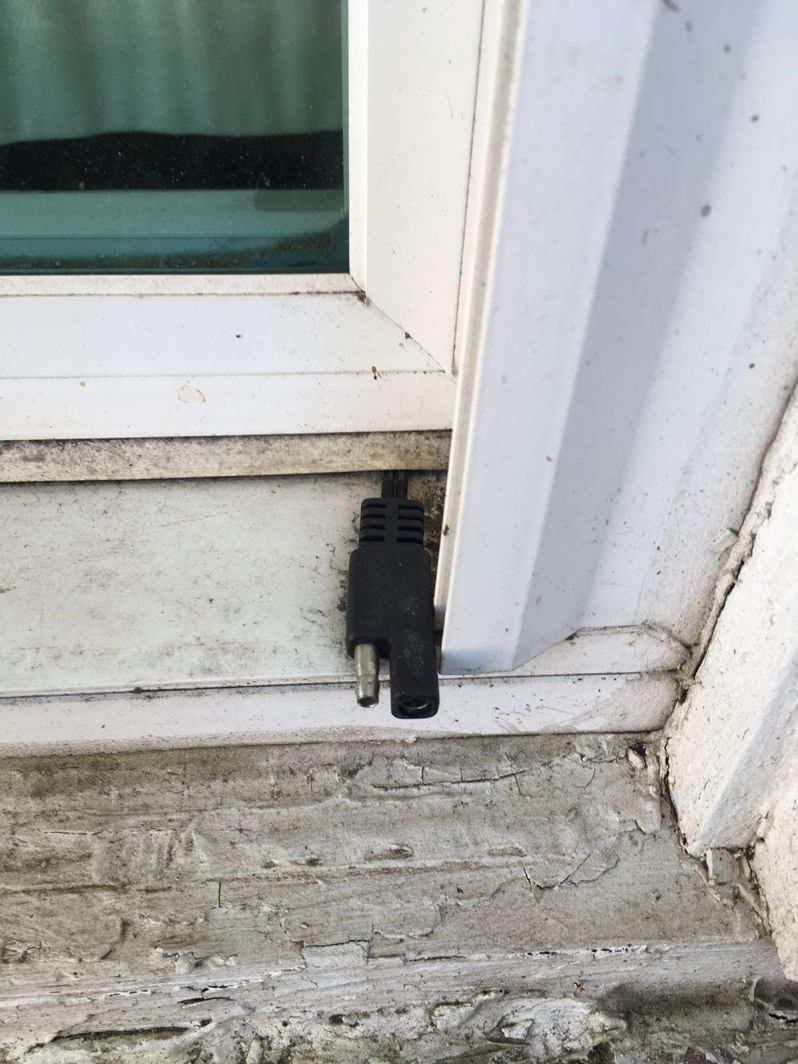

This is the lead from the charger that I leave sticking out from under the window. Yes, I know about all of the maintenance that needs to be done on the house here. Did I not mention all of the projects I am in the middle of? And this is the north side of the house, so just wait until you see all of the green growing onto the bricks that needs to be killed off. The window itself is a double-pane argon-filled thingy. This means that the wire has several permanent crimps in it, but it continues to work well after six years.
6 Lead out window.JPG (148.19 KiB) Viewed 8759 times

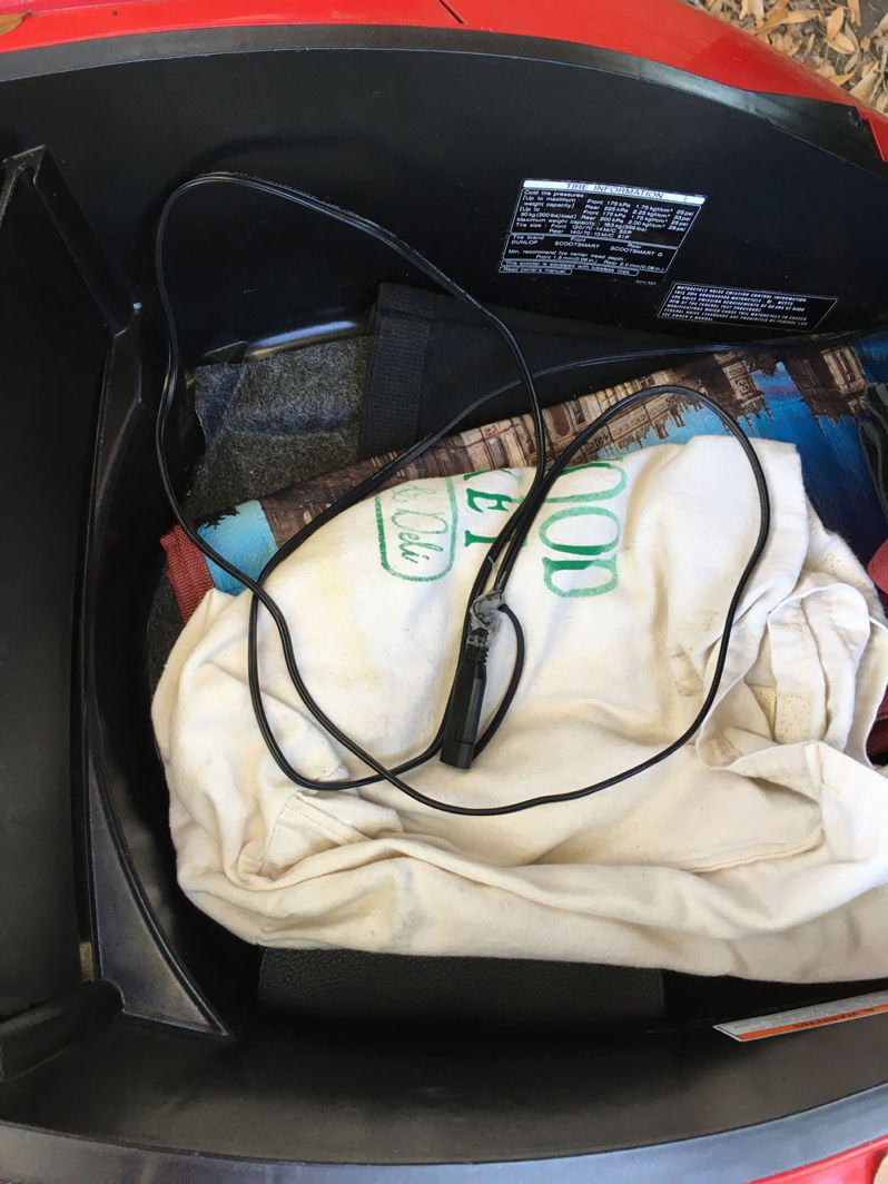

When I’m not charging the poor beast and just riding around, I simply cap that long wire and toss it under the seat (along with all of the shopping bags and sunglasses):
8 Lead under seat.JPG (136.09 KiB) Viewed 8759 times
