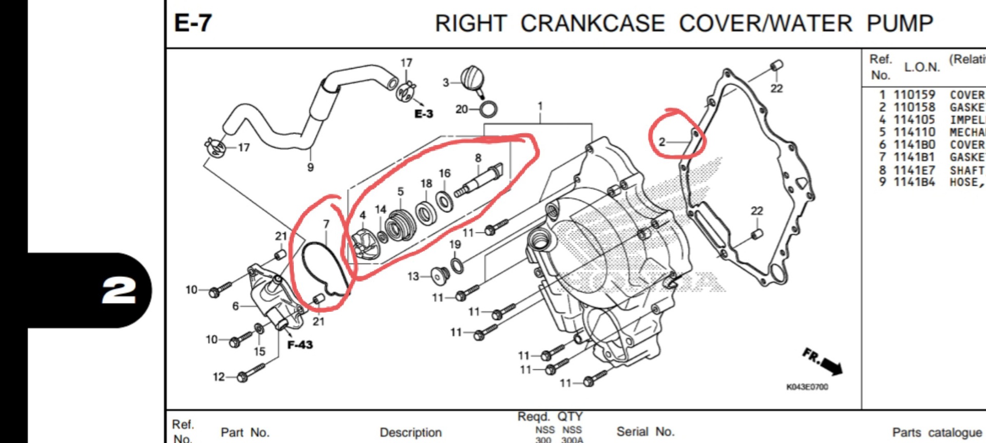

I've attached an image of the parts that I believe are necessary to fix the leaking coolant/oil. Am I missing anything or would this be all? Right crankcase gasket, water pump gasket, 2 seals, 2 washers, pump shaft, impeller.... anything else?
3 local shops all gave me different labor rates; $270, $330, and $450 :? I'll call a few Honda dealerships and see what they charge.
They've gotta drain the fluids, remove the muffler, right crankcase, water pump, and then assemble the new water pump pieces.
