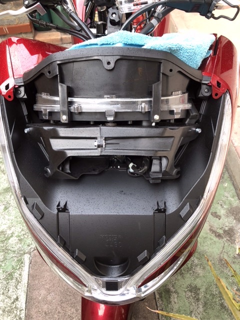

Needed to work on electrical accessories so I took off the meter panel. On my ‘17 PCX150 you could see a lot of wires. With the 2020, it’s both but more plastic covering the wires. So now it looks like a Japanese car in the engine area with all wires covered with some type of black plastic trim.
What I could use is advice on tapping into the low and high beam light signal, but where now that it’s all hidden away under plastic?

Here’s a picture
Re: Plastic everywhere
What you're looking at is the sealed unit non-maintainable LED headlight assembly which is huge.
There will probably be a single plug-in connector at the rear somewhere, have a look from underneath.
