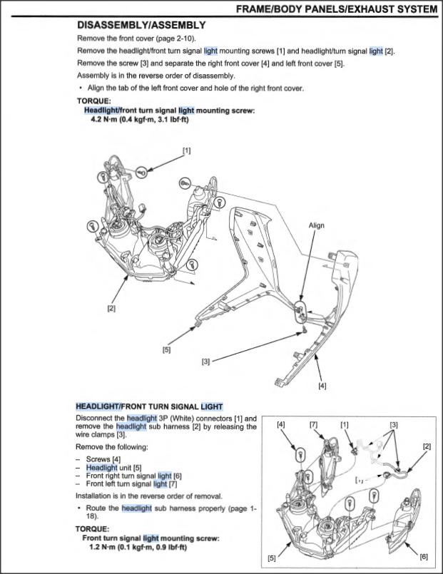

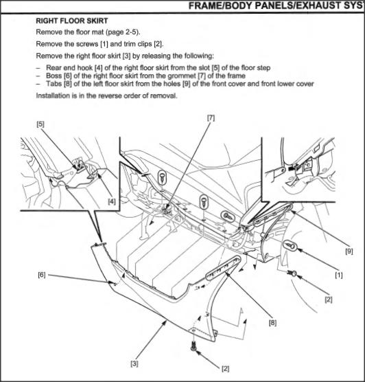

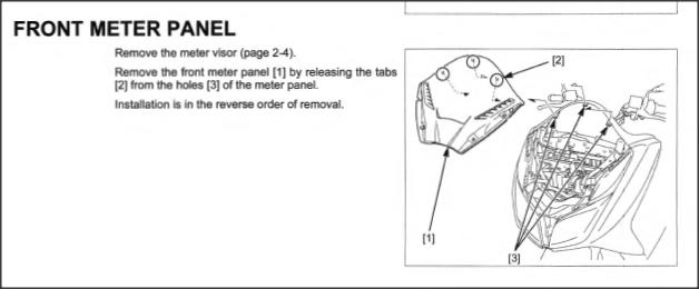

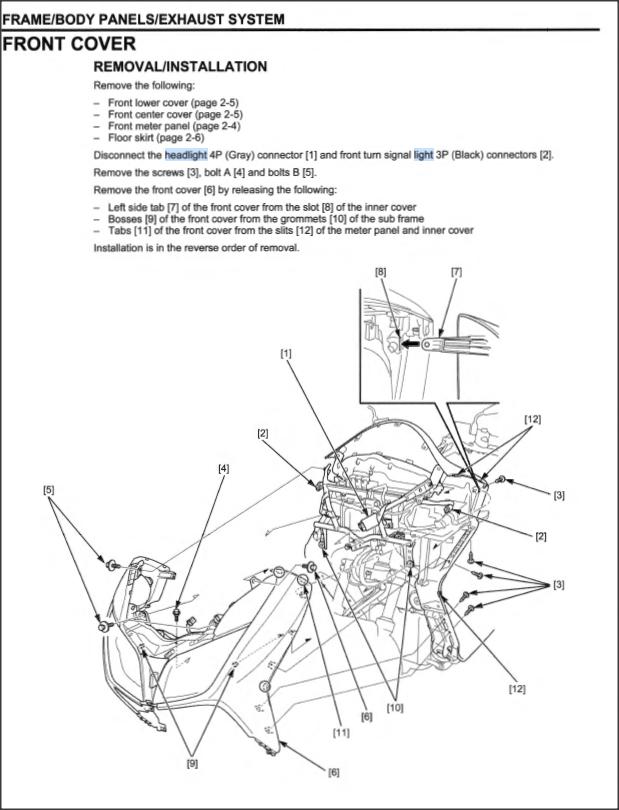

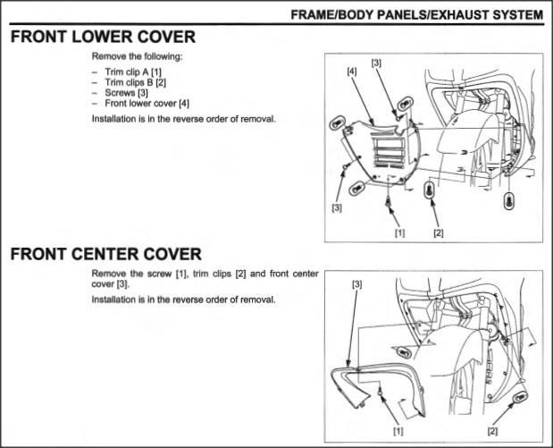

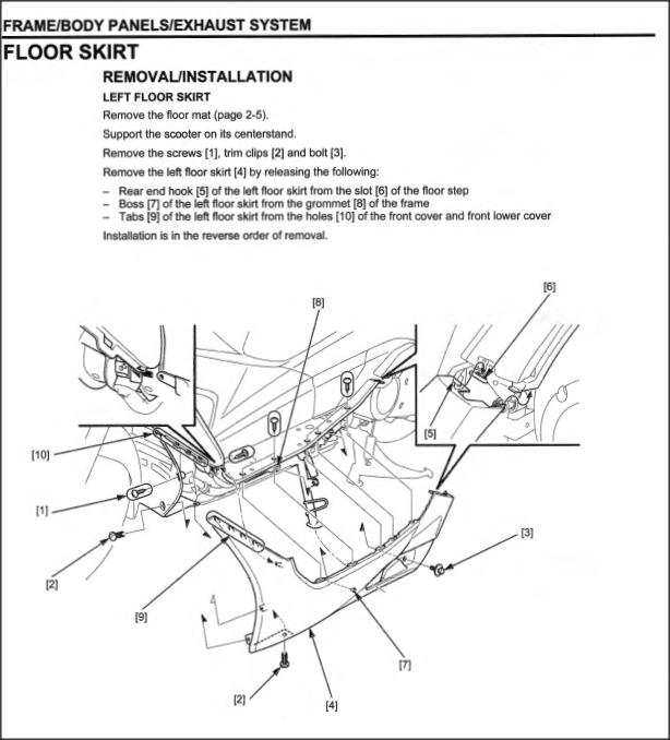

This help? The Front Cover page (6) tells you to remove the Lower Cover then the Center Cover then the Front Meter Panel and then the Floor Skirt. THEN you can remove the Front Cover which includes the headlight assembly.

Limey wrote:This help? The Front Cover page (6) tells you to remove the Lower Cover then the Center Cover then the Front Meter Panel and then the Floor Skirt. THEN you can remove the Front Cover which includes the headlight assembly.
Wow! Yes! I think that's exactly what I was looking for. Where did you find this? Is there a higher resolution version I can download for myself, somewhere? Thank you so much!
