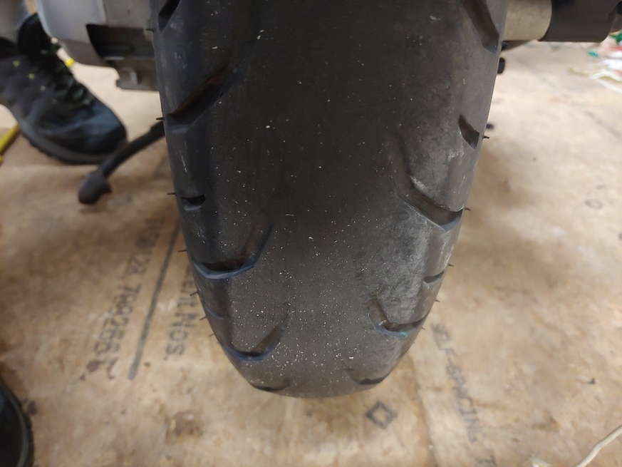

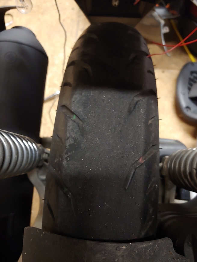

I have the service manual & it mentions the tread limit for the tires but doesn't mention where I'm supposed to measure.
I have about 7500 miles on the bike. I have attached pictures of the tire. Hows it looking?

I can see you reached the tire's wear mark in the second pic..
Time to change..

Where is the wear marks? Because i totally don't see it. lol.

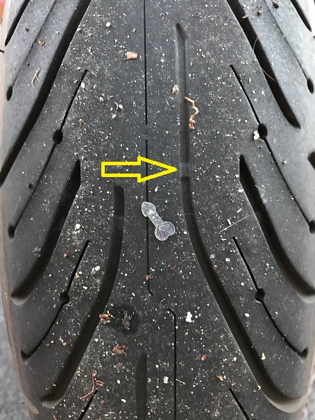

if my eyes are not tricking me, it's this one
it looks like this new

Rear tires usually need to be replaced at around 5,500 miles. Front tires last almost twice that. Your rear tire is way beyond the point where it needs changing. I am betting that it does not hold very well on wet roads.

The siping on the sides is good, so it is probably not too bad even in the wet in corners. Stopping's where the issue will happen, because your back wheel will just lock up and you'll be sideways. I'd have gotten that replaced a few thousand miles ago, as alx123 and Mel suggested.
