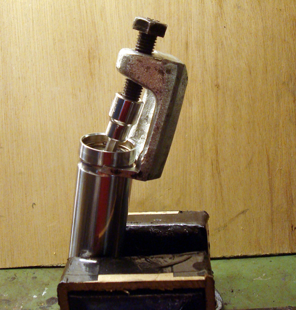

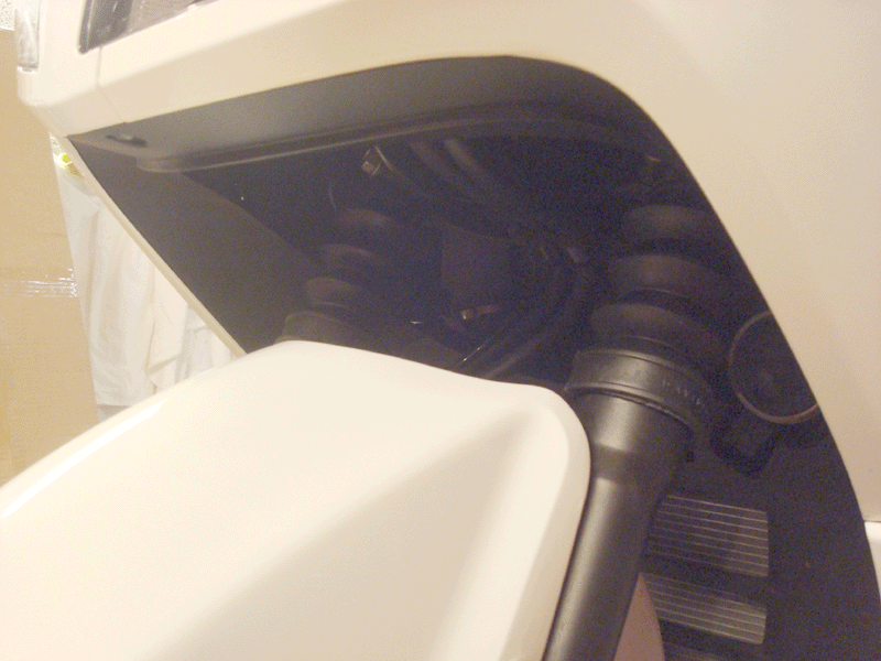

I have changed the fork oil in my 2017 Forza 300, up from 10 weight to 12.5 weight. Not sure if it will make much difference and the weather is a bit grim to try it out. To change the oil the fork legs need to be dropped out and the end caps removed by compressing the cap against spring pressure whilst a pesky little wire clip is teased out….it’s a 3 handed job unless…….
I had an old ball joint separator tool in my junk box, (useless things these) and with a little sawing and filing was able to make a spring compressor ideal for the Forza fork leg. The tool locates in the groove near the top of the fork leg and hold the cap down against the spring to allow the wire clip to be removed much more easily. Well worth the effort to avoid the 3 handed contortions.
And since the fork legs were off I added a pair of fork gaiters. They were made to fit a Harley Davidson of some sort and look OK on the Forza, not a perfect fit but passable. If they prove to be a problem it is an easy job to remove them with a sharp knife.

Gaiters look good. I think I'd zip tie the lower ends.GrahamH wrote:I have changed the fork oil in my 2017 Forza 300, up from 10 weight to 12.5 weight. Not sure if it will make much difference and the weather is a bit grim to try it out. To change the oil the fork legs need to be dropped out and the end caps removed by compressing the cap against spring pressure whilst a pesky little wire clip is teased out….it’s a 3 handed job unless…….

GrahamH wrote:.....And since the fork legs were off I added a pair of fork gaiters. They were made to fit a Harley Davidson of some sort and look OK on the Forza, not a perfect fit but passable.

The gaiters are cheap Chinese found on Ebay and not best quality, just go by dimensions

To get that first retaining clip out, I wrapped the top of the fork in a rag. gripped it firmly in the vice and then used an F-Clamp hooked under the vice to gently screw down the end cap.
