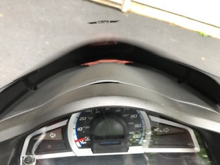

Has anyone had this happen to their PCX? the dash under the windshield has risen up a bit. I am concerned with water getting in there. Anyone dealt with or fixed this issue on their bike?

I had the same thing happened to my bike, after I took those pieces apart to splice in a power lead. If you take the pieces apart again , you will see that right at the top there is a small little indentation/tab that will make it fit correctly.

Don't worry about water getting in there. The dash gauges are sealed and only some relays are under the cover.

thanks for the feedback. It may have happened when I put on the new windshield. I don't recall taking that area apart but I may have put stress on it.
