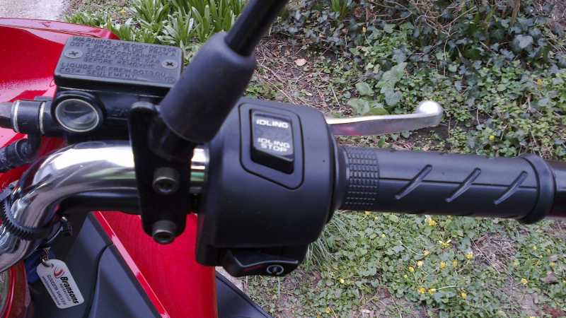

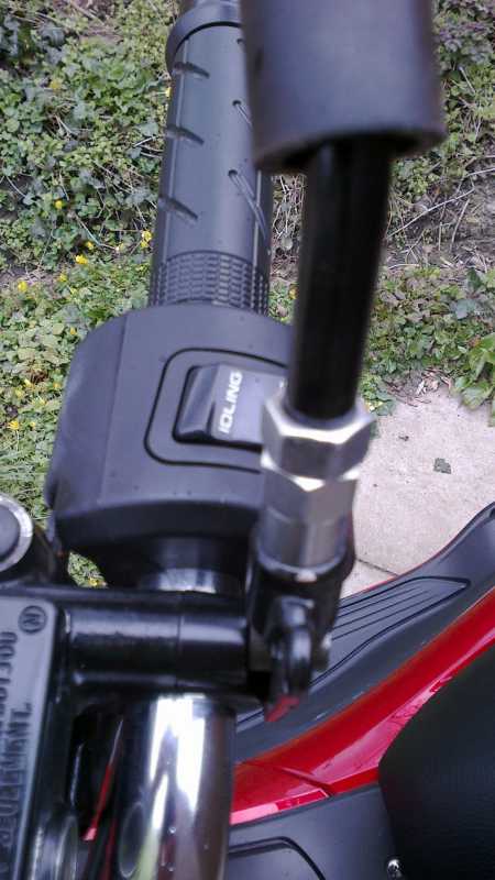

tomtic
Posts: 70
Joined: Mon Oct 29, 2012 4:50 pm
Location: West Dorset, England
Re: GIVI mirror extension kit wrong threads
Post by tomtic »
Wow, there's some good info here!
Now to 'throw the cat amongst the pigeons' ....... my mirrors do not screw into the threaded bosses which form part of the brake assemblies. They thread into small brackets attached to the brakes like this:-
I have a 125 ESP with the Honda large screen fitted by the dealer. I can only think the kit comes with the brackets for the dealer to fit? It places the mirrors about an inch and a half (4cm) further away from the screen towards the rider. Honda may have come up with this as a 'solution' to the mirrors hitting the screen?
Anybody else have this attachment?
