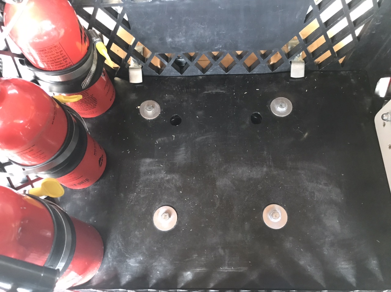

Re: What have you done to improve the PCX suspension?
MikeP wrote:I installed YYS shocks.
Airhawk seat cushion
Someone’s prized sheep on the cushion
This combination has allowed me to ride 4-500km in a day with total comfort.
I like the crate box on that. How did you mount it?

- MikeP
- Posts: 412
- Color: White /red
You you: I cut a sheet of plastic for the bottom and just bolted it to the top rack.
