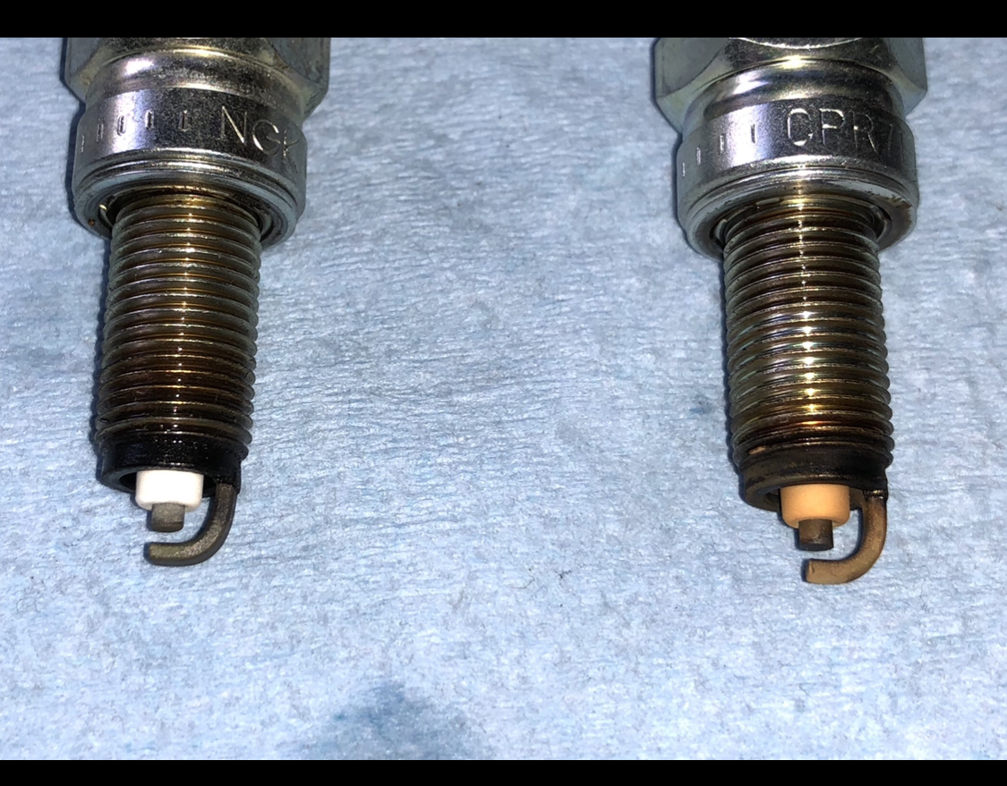

Update on spark plug
Yes i tightened it..
But look what the heck this plugs been doing
Plug Left is original, Plug Right is what I put in
Darn thing is Burnt or burning something in the fuel
Could spark Ping be loud enough to duplicate a rod knock?
Isn’t a rod knock Consistant all the time knocking?
If that’s spark ping- i am burning a whole in my piston
Haven’t tested old plug yet

it’s After oil and plug and filter and cleaning cvt vent that the rattle started..
Wife asking me to cook
- B2F6FF3C-FD0E-45EE-AFA8-6F6378E7AA04.jpeg (975.53 KiB) Viewed 17479 times

This thing is Silent at idle, even that 1st bike sounded worse than this, I heard a little rattle near end of video clip
So our variator acts like a Speaker was a Correct way of putting it..
Pulling all fuel out of this thing
(Look at Plugs- that was now Today)
- MichaelGee
- Posts: 68
- Joined: Thu Jun 04, 2020 8:05 am
- Color: Obsidian
- Location: Lakeville, Michigan
Re: 2015 PCX 150 sounds like a Rod Knock
All fuel is out, and i saw the Low Fuel flash for the 1st time, that’s cool..
Super Clean fresh fuel is in..
Let it idle for 5min, then shut it off for about 15min
Fired it up and went for a 10mph ride for a mile or so around our sub, this thing really Sips the gas so, i know it’s going to take a bit for Real fuel to be flowing solid. Punched it a couple of times to push fuel in, but short streets right to deceleration.. didn’t give it a chance to even speed rattle, pulled in and shut it down..
A little leary with that new plug looking like that, whether or not I fried my o2 sensor, any thoughts on this “?”
Engine management will advance retard spark based on content sniffed, this thing may have went on the offensive timing side with additives in fuel (see 1st post), added shot glass of Lucas fuel injector cleaner lubricant at plug oil filter change, since i didn’t know what happened prior.. Then knock or pings slowly started happening.. Then 3 shot glasses of octane booster.. fuel looked cloudy Yellow
Really thank everyone for responding, means a lot to this old fart..
So I’ll take it out tonight for higher even speeds with my ears turned on, and post results
I know it’s going to take quite a bit for closed loop fuel/timing management to start managing the maps correctly..
i just hope the piston isn’t too far pitted, the bearings aren’t toast, the o2 sensor isn’t fried.. Sounds like I’m cooking dinner again.. Your posts along with me re-reading mine, really helps out on possibilities.. So i am hopeful..
Thanks for the heads up on Walmart synthetic oil being fine to use.. Still can’t believe it was $53 bucks to overnight ONE quart of HP4M
