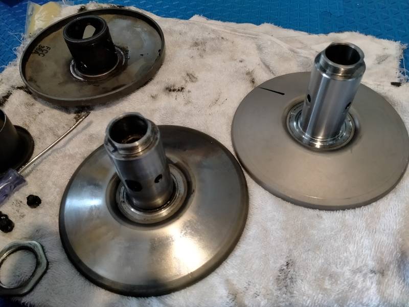

So I changed my clutch set lately as the bearing is starting to make a sound. Bought an aftermarket one instead of the OEM, silly me. The clutch pad that came with the set is not good so I changed it into a much better pads to avoid the clutch shudder problem. With that, the new clutch ran smooth, not a hint of shuddering.

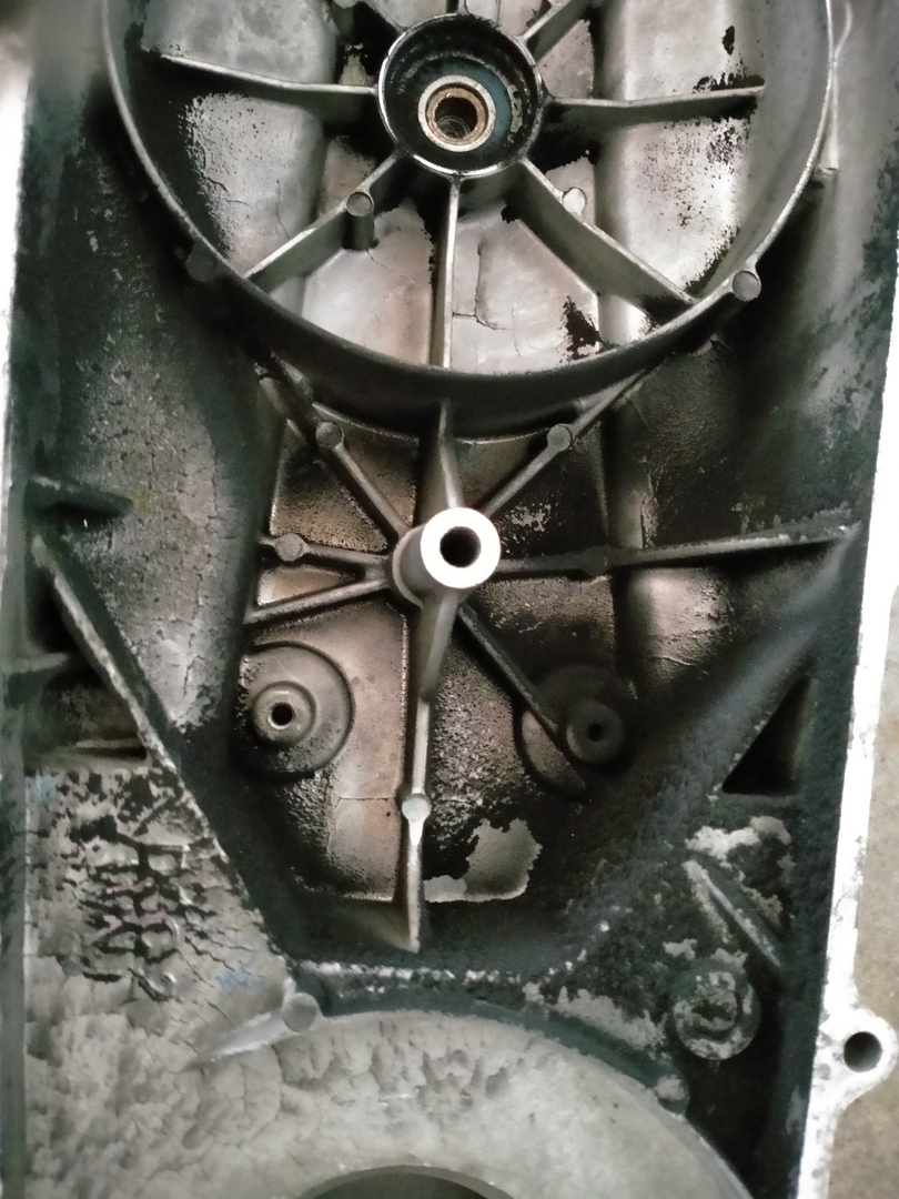

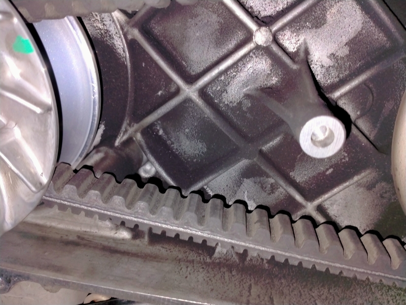

I opened it today to see how the drive parts are doing, and to my surprise, I see dust of black soot everywhere. I know it's my belt being grinded but not sure which part of the new clutch is causing it. Tried running the engine and see how it is but everything seems to be working fine. Smooth, no grinding sound, seems all fine to me.
Checking the belt, it seems fine. I can't even pinpoint which part is being grinded.
Who has any idea what's going on here? Remember, I only changed the clutch set, so the belt is not really new but it's not that old either ( 5k kms).
Should I be worried and buy an OEM clutch set instead?
Maybe I should clean it for now and see how it is after another 100 kms, maybe the belt is just setting in for the new clutch?
Inputs will be appreciated.

Hi, thanks. Yeah, that's what I'm thinking too, replace the clutch set and the belt with OEM.

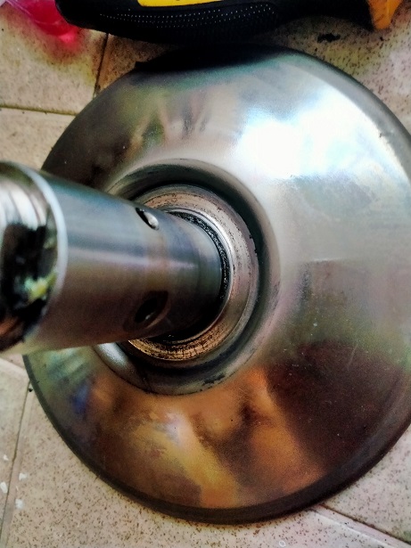

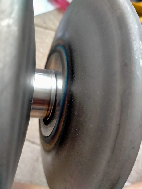

I decided to open the clutch today and compare it with the original I replaced.
It seem that the OEM has more space to accommodate the belt during higher speed (see photo)
below is the aftermarket one im currently using and as you can see there is no sunken space like the OEM one above..
so I'm guessing it's slightly pinching the belt at higher speeds..(you can even see some black soot of rubber in the photo below
My plan now is to either buy a new OEM one or try to swap the bearings between these two and use my old OEM instead.
Let's see what happens as it started to get dark here and I decided to take a break..

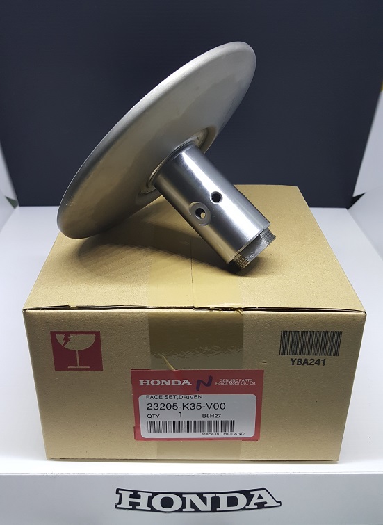

I can't seem to find them anywhere here, the shops sells the driven face instead (see photo). This is better than buying the entire clutch set.
@Youyou, Gn2
That seems to be the case. Taking these bearings out seems harder than it looks, especially without the right tools. Iv'e tried and failed, so I don't want to push it harder and damage the bearings as you've said.
I think I should buy a new OEM driven face instead.

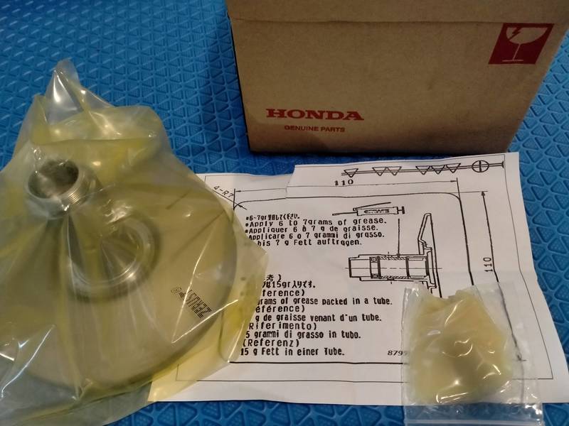

My OEM parts arrived today; Movable face(US $31), Belt (US $11).
The OEM face came with a pack of grease and an instruction that says I should put around 6 grams of grease on the bearings and inside the tube using the hole on the sides.
After putting some grease, I immediately installed it and changed the belt. The old belt still looks okay and will serve as my reserve. Now my drive parts are mostly OEM, except for the rollers and the clutch pads (OEM pads suck).
With this I've learned that when it comes to important parts, OEM is the best. I also realized that every time I open my drive parts for cleaning and maintenance,I should also re-grease the bearings.
I've wasted some $ on a bad aftermarket clutch but I've learned how to disassemble and maintain the clutch. I'll take that as a win.

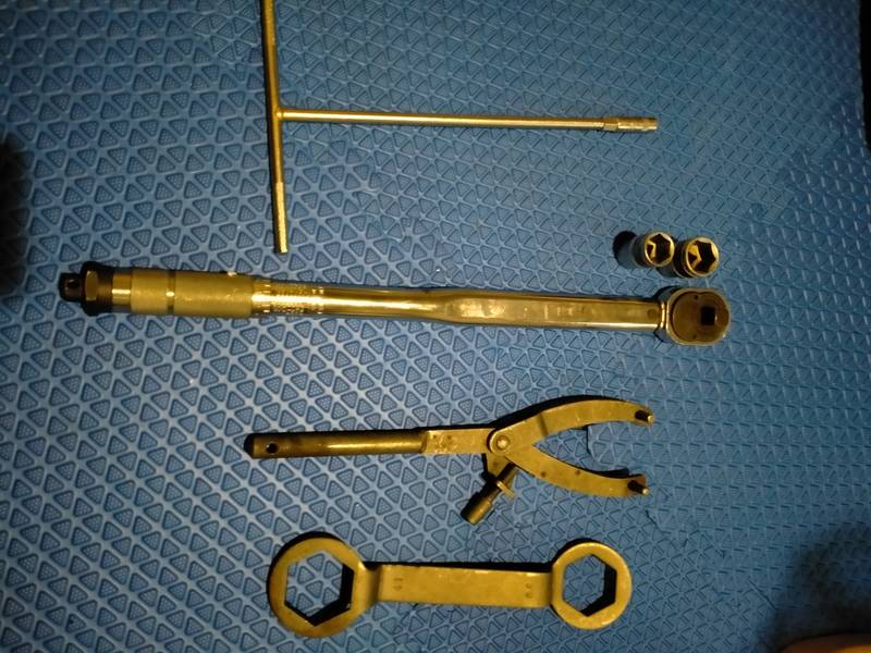

The tools I used to open the variator and clutch.
8mm wrench to remove the cover, torque wrench (size 19mm - 36 lbs torque for clutch, size 22mm-42 lbs torque for the variator), clutch tool, 39mm wrench for the disassembling the clutch.
