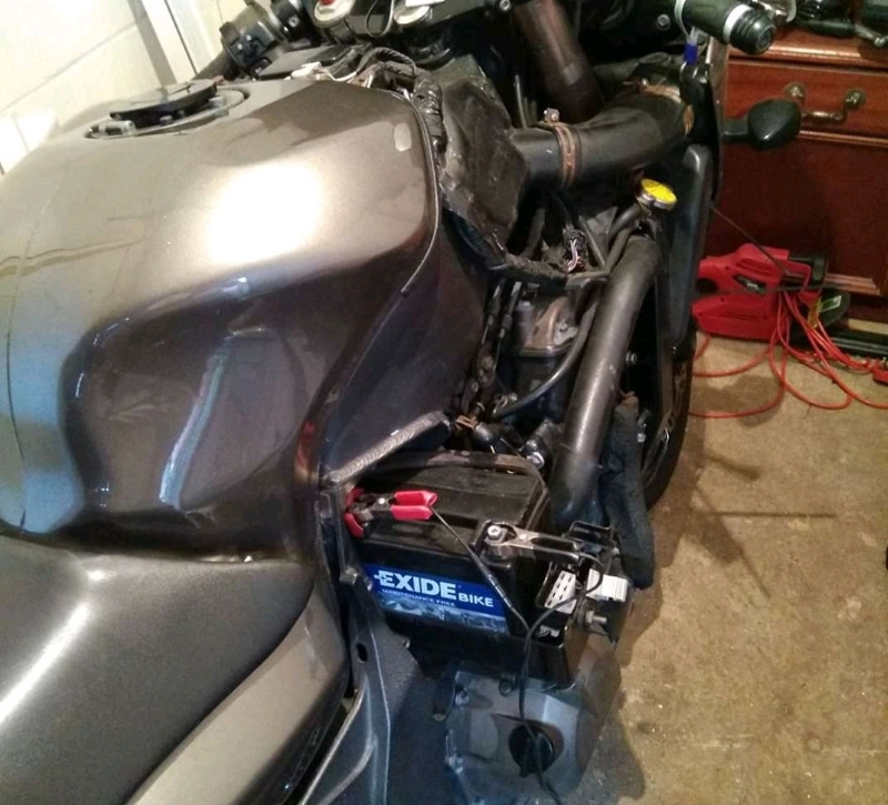

If you thinking getting t the battery is fun on the Honda you should try the Kawasaki ZX12R, you have to take half the bike apart to get to it
- Charging the battery Small.jpg (377.1 KiB) Viewed 14737 times

ZX12R definitely needs a pigtail connector.............The switch to AGM batteries.......great improvement.
