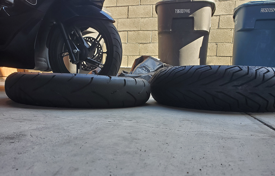

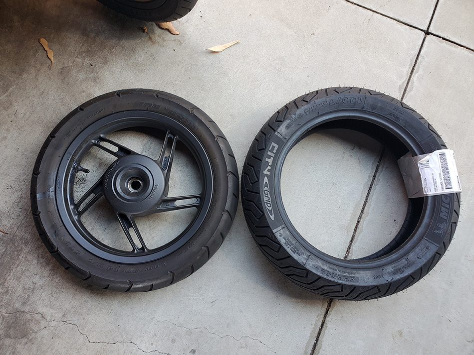

So I’ve seen a lot of posts about tires. But never a good explanation
I had ordered 120’ss for the front and was gonna do the 140’ss for the rear. But I want to know if that’s risky or not? Or should I stick to the oem size? Also has anyone changed they’re bars? And bar ends. ? Thanks :ugeek:

Pcx? I think there was a recent thread about the new tire size on the older bikes. The new rims won't fit the older bikes, and I think someone mentioned concern about the width of the new tire at the rim on the older rims. My suggestion would be, you can try them and let us know of any problems.

I've never felt a need for wider tires since Michelin City Grips work very well in the stock size; however, from what I've seen of other people's experiences, you're going to have some rubbing with the sizes you've referenced. some owners have safely gone up one width size on each tire without any major adjustments, but you still may need to take off the rear splash guard.
There's some crazy wheel and tire combinations that have been done on the PCX, all of which seem to come out of southeast Asia, including what look like thin mountain bike tires. Just the same, I still think the stock size is the best choice.

Iv'e read that the OEM rim is narrow and attaching a wider tire will create a squeezing effect on tires and will actually reduce the contact area.
1 size up won't be a problem though..

Take it from someone running bigger tires. One of the best things I did. 140 rear 120 front(i think).
Speedo does read low but no big deal. Rides muuuuuch better and highway feels night and day.

I think it's risky. Increases chance of crashing and getting killed. Also insurance would make a big deal out of you modifying the original tires so they might blame you for the damages.
No need to change tire sizes. OEM will stay in place whereas oversized ones are likely to come off under certain conditions.
You have to use the tire that the rim is made for.

Unless you have experience with someone that has had this happen, Its not that big of a deal.
The tire wont come off the wheel if its inflated properly and installed correctly. I run my bike harder than most with ZERO issues. If you plan to keep the bike completely stock and rarely go over 60, stock size is fine.
Anything over that on stock size tires is much more dangerous. The stability of the bike with larger tires is night and day. Once you change the Variator 70+ is pretty easy, and stock tires at those speeds is horrible.

I have been running that tyre size for the last 2 years and it's one of the best changes you can make. You will need to adjust your air pressure accordingly as with more volume you need less psi. I typically run 28-30 in the rear and 25ish in the front unless I'm doing a lot of 2up riding then I add 3-5 psi. My bike handling with that and the new rear shocks is night and day better than with stock, and soooo much better for riding any long distances.
