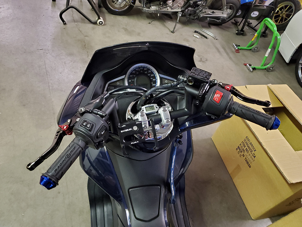

Bar and bar ends are no more difficult than on any other bike. A pain can be the bar end screws though due to the threadlock compound. Properly fitting screwdriver and a whack with a hammer should sort that. Or an impact tool if you have one.

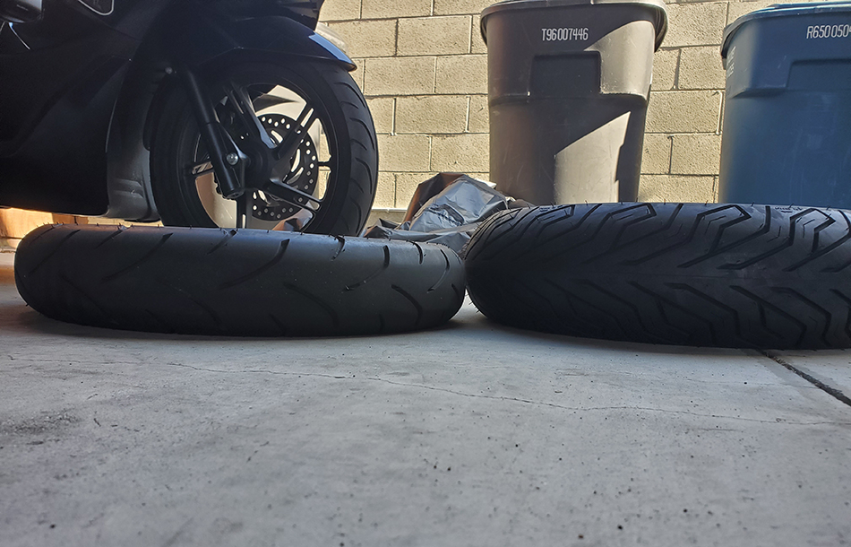

I've never felt a need for wider tires since Michelin City Grips work very well in the stock size; however, from what I've seen of other people's experiences, you're going to have some rubbing with the sizes you've referenced. some owners have safely gone up one width size on each tire without any major adjustments, but you still may need to take off the rear splash guard.

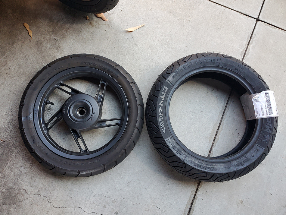

Iv'e read that the OEM rim is narrow and attaching a wider tire will create a squeezing effect on tires and will actually reduce the contact area.
1 size up won't be a problem though..

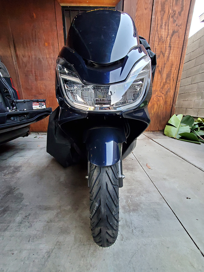

Take it from someone running bigger tires. One of the best things I did. 140 rear 120 front(i think).
Speedo does read low but no big deal. Rides muuuuuch better and highway feels night and day.

The tire wont come off the wheel if its inflated properly and installed correctly. I run my bike harder than most with ZERO issues. If you plan to keep the bike completely stock and rarely go over 60, stock size is fine.
Anything over that on stock size tires is much more dangerous. The stability of the bike with larger tires is night and day. Once you change the Variator 70+ is pretty easy, and stock tires at those speeds is horrible.

HEAT applied to the very tip of the bar end helped it come out on my son's CB500X.

Venom_Pcx wrote: Also has anyone changed they’re bars? And bar ends. ? Thanks :ugeek:
Yup.
Z-Bars went on easy.

I have been running that tyre size for the last 2 years and it's one of the best changes you can make. You will need to adjust your air pressure accordingly as with more volume you need less psi. I typically run 28-30 in the rear and 25ish in the front unless I'm doing a lot of 2up riding then I add 3-5 psi. My bike handling with that and the new rear shocks is night and day better than with stock, and soooo much better for riding any long distances.
