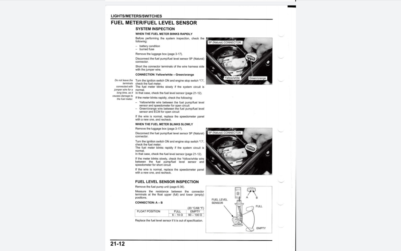

The fuel level sender in your gas tank might be at fault. You could check it with a voltmeter. It will require to remove many panels though.
Re: Pcx 125 - gas gauge Always flashing
I don't know if this will help you or not, but here is a page from the service manual that relates to the fuel sensor.
Screenshot_fuel sensor.jpg (162.35 KiB) Viewed 3179 times
