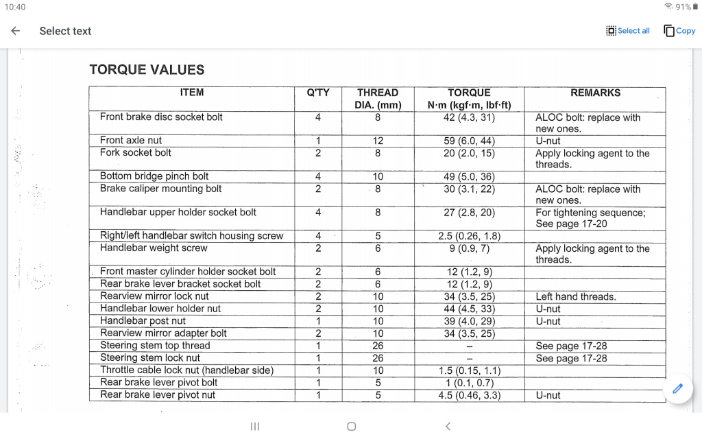

Hi guys! My first post here, just bought my first scooter and it's a pcx! (Been a Honda fan for ages).
I need to service the front fork as in change o rings + dust seals, replace the front breaking disk and change the break pads.
Can anyone help me with the tehnical specs for all of my job please as I can't find any torque measures or the amount of oil that goes in the fork!
Thanks in advance!

Re: Pcx 125 2014 front wheel help
I hope this helps.
steering torque specs.jpg (210.28 KiB) Viewed 3173 times

Mel46 wrote:I hope this helps.
Yes it does, thank you alot, anywhere in the manual can you find the amount of oil that goes into forks? Thanks in advance!!

2013-2015 PCX 150 USA Recommended fork oil Pro Honda Suspension fluid SS-8 [10w] or equivalent.
Capacity 122.0 +/- 2.5cm\3
4.13 +/-0.05 US OZ, 4.29 +/- 0.05 Imp oz
