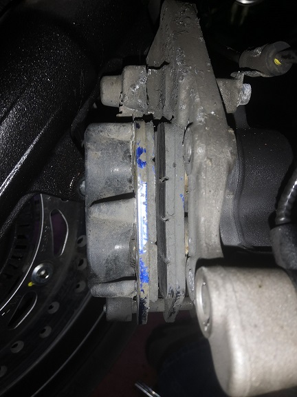

Found the pads for just under £30 ha to search for the Forza 125 ones like GN2 suggested (thanks), it look to have about 2-2.5mm left?

Those in the picture look almost like new. If you take a wire brush to the pads I bet you have more than you think. Mine were like that.
I have a 2014 Honda Forza 300.
My first set of front brake pads got replaced at 16,940 km.
I then greased the pins properly and the second set of pads were replaced after 100,107 km of use.
The second set were not worn out and I may put them back in at a later date.
I do use both of my brakes when stopping but the CBS braking system is a little different than my previous motorcycles. Having the engine attached to the rear swingarm is different than motorcycles.
My dual sports have all worn out the fronts faster than the rears. The Forza eats rear pads but a good greasing improved that as well. I got 20,000 km out of one set of pads.
I tend to be easy on my brakes, I coast up to a stop sign. I look well ahead and let off the throttle early. I also tend to do long distances on the highway with very little brake use.
It is snowing right now and the scooter will stay in the shed for a few more weeks. I want to go RIDING!!!

Thanks I will take them off again tomm and clean them up, do you know the oem thickness, see how we go, I thought they were well worn.

I have some cheap SOK pads for the Forza lying around. The pad material new is 5.0 mm.

Hi
Stripped both sets of brakes down today, greased sliders as Honda seemed to have run out of spit
cleaned everything up and rear pads have about the same as the front thickness wise 2.5mm maybe a tad more.
Front pads had no shims on pads and rear only had a shim on the piston side, I would think there is about 2k left in them and would prolly need changing same time as tyres, surprisingly the rear was in good order

Brake pin grease is an easy insurance policy!

Nothing wrong with those pads pictured.. Plenty of life left as mentioned.
