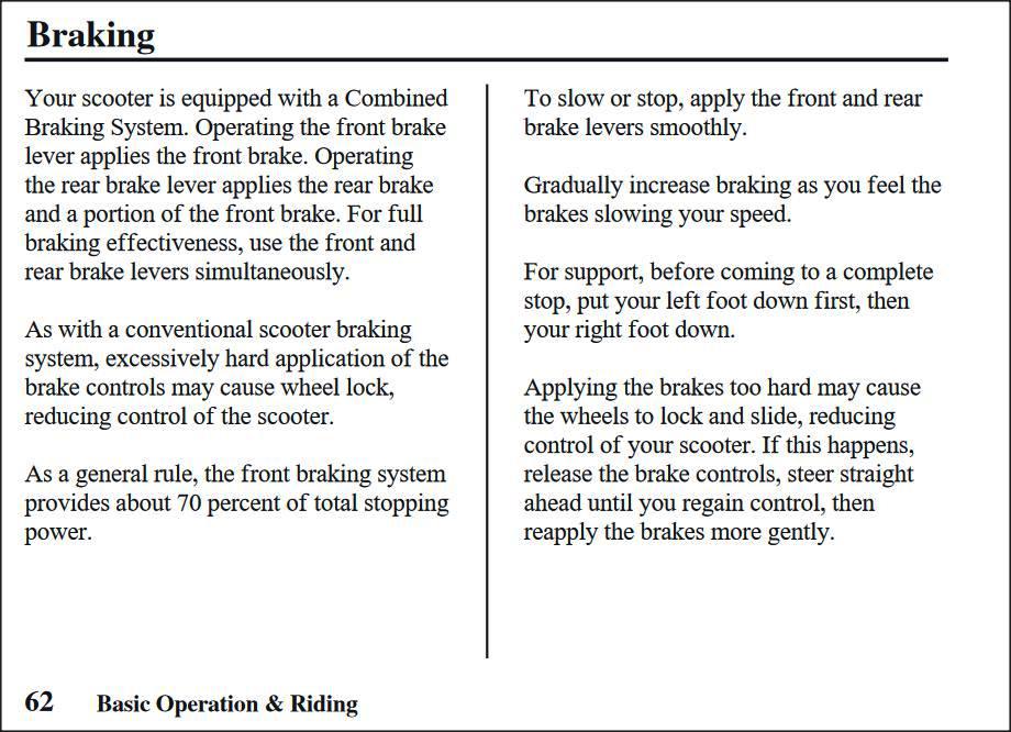

Re: About CBS fuild.
Nope - LEFT is front and Right is CBS. Its is made to be confusing by the way they label the levers in the manual:grndslm wrote:Wait a second...gn2 wrote:Left lever works both rear wheel brake by cable and front brake by hydraulic fluid.
I thought the RIGHT lever worked both front and rear brakes,
While the LEFT lever worked rear only.
- Snap 2019-10-29 at 09.25.00.jpg (72.4 KiB) Viewed 6937 times
- Snap 2019-10-29 at 09.25.31.jpg (107.29 KiB) Viewed 6937 times

And it still would not let me get it right. Not enough coffee yet!Limey wrote:You- you, you posted as I was editing my post! LOL
To get it right once and for all the LEFT is the CBS (Rear and Front) and the RIGHT is the FRONT brake only. What GN2 originally said.

The first page(s) you show say that left is rear, right is CBS... which made the most sense, theoretically, because the entire purpose of CBS was so that someone couldn't lock up the front brake by itself, right?? Why would CBS be applied to the rear brake, where that brake (especially a drum rear) would never lock up anyway??
However, that last picture does seem to be more accurate, based on what I feel while riding. Right brake definitely works pretty good for trail braking.... But it just blows my mind that the entire concept behind CBS isn't to prevent ANY wheel from locking up, but to add more bite to the rear drum for a n00b squeezing left brake only in a panic. Learn something new every day!
The OP has a 2016, so it is as I show in my last picture, with the reservoir. I also checked in the service manual and it has been that way since the 2013 model.
