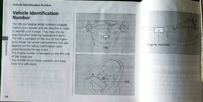

I know there is one under the seat, one near the key hole, and another on the back (on the sticker) are they any other VIN locations?

From my U.S. - 2015 PCX 150 Owner's Manual Pg. 98:
"The VIN is stamped on the rear of the frame body inside the center compartment and also appears on the safety certification label attached inside the leg shield."
(Pg. 98 and 99 illustrations - pic to follow)

Photo taken from 2015 owners manual:
- Resized952019102395153507-702x355.jpg (68.17 KiB) Viewed 25583 times
