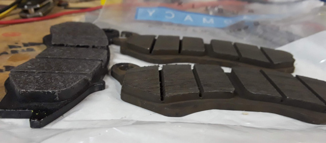

I pulled the brake pads from my wife's bike yesterday and was surprised. I had planned on changing them, since the bike has 13,000 miles on it. The pads only look like they are half way down! Here is a picture. New one is on the left.
new brake pads & old.jpg (58.11 KiB) Viewed 7424 times
If they are still good, how long do these pads last?!

Mel46 wrote:I pulled the brake pads from my wife's bike yesterday and was surprised. I had planned on changing them, since the bike has 13,000 miles on it. The pads only look like they are half way down! Here is a picture. New one is on the left.
By the look of it,id say 26,000 miles?
