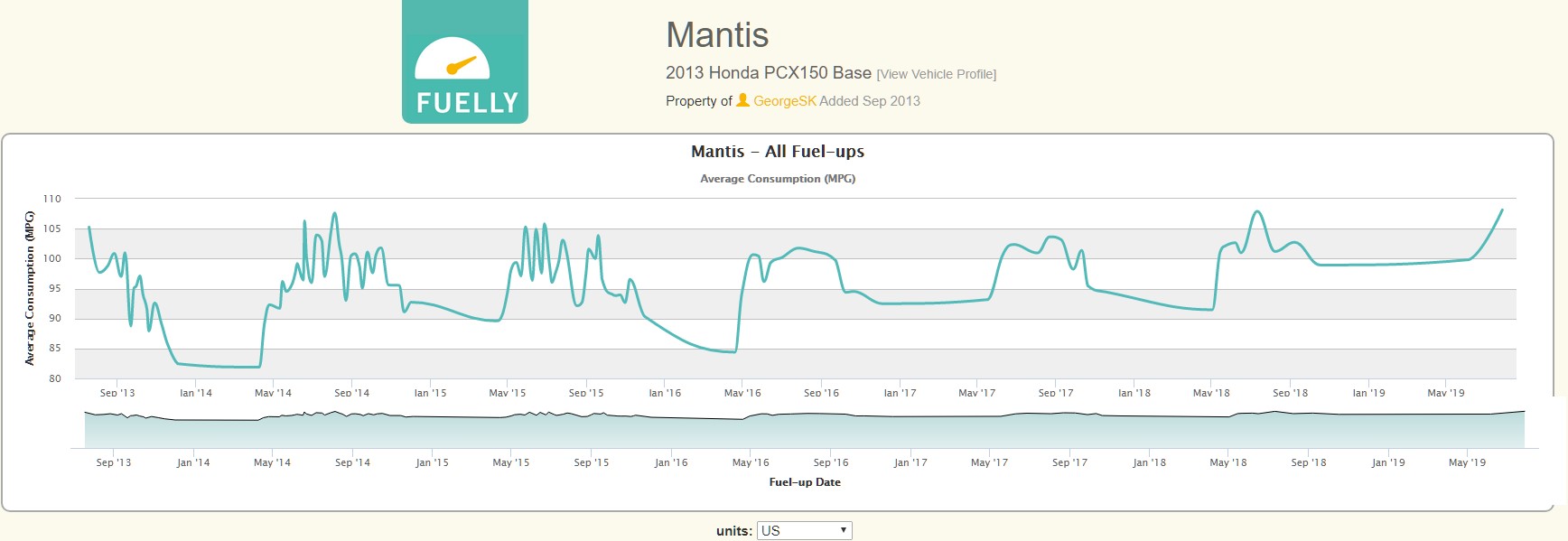

I definitely see a drop in fuel economy when it gets cold. I'm not sure that the Sta-bil has a detrimental effect (a half ounce doses the '13 PCX tank - hard to believe it could have THAT significant an effect), but one never knows. You can see on my fuelly history that I get my best mileage in the dead of summer, and that tank that goes through the winter is comparatively abysmal.
Mantis Milage.jpg (113.12 KiB) Viewed 4460 times
I no longer commute to work or ride the PCX on a regular basis, so fillups are much fewer and farther between than before. That too is probably not good for my mileage. I now put Sta-bil in every tank -- there is no knowing how long it will be there. As an aside, I can only get 10% ethanol gasoline in my state unless I go to an airport. Ethanol gas has less energy content than "pure" gas, so it figures that mileage will be down when you use it.

GeorgeSK wrote:I definitely see a drop in fuel economy when it gets cold. I'm not sure that the Sta-bil has a detrimental effect (a half ounce doses the '13 PCX tank - hard to believe it could have THAT significant an effect), but one never knows. You can see on my fuelly history that I get my best mileage in the dead of summer, and that tank that goes through the winter is comparatively abysmal.
I wonder how much of this can be attributed to winter blend fuel. I do know that along with cold weather (at least in my state), winter blend fuel give me a noticeable difference in fuel economy.
Taken from this website... https://www.goldeagle.com/tips-tools/wh ... mer-fuels/
"The other reason for the higher cost of summer-blend gasoline is that refineries have to briefly shut down to transition from winter to summer blends. This typically occurs starting in April, allowing gas stations to start selling the summer blend by May or June. They can then switch back in September."
This fits almost exactly with the readings on your Fuelly mileage report.
