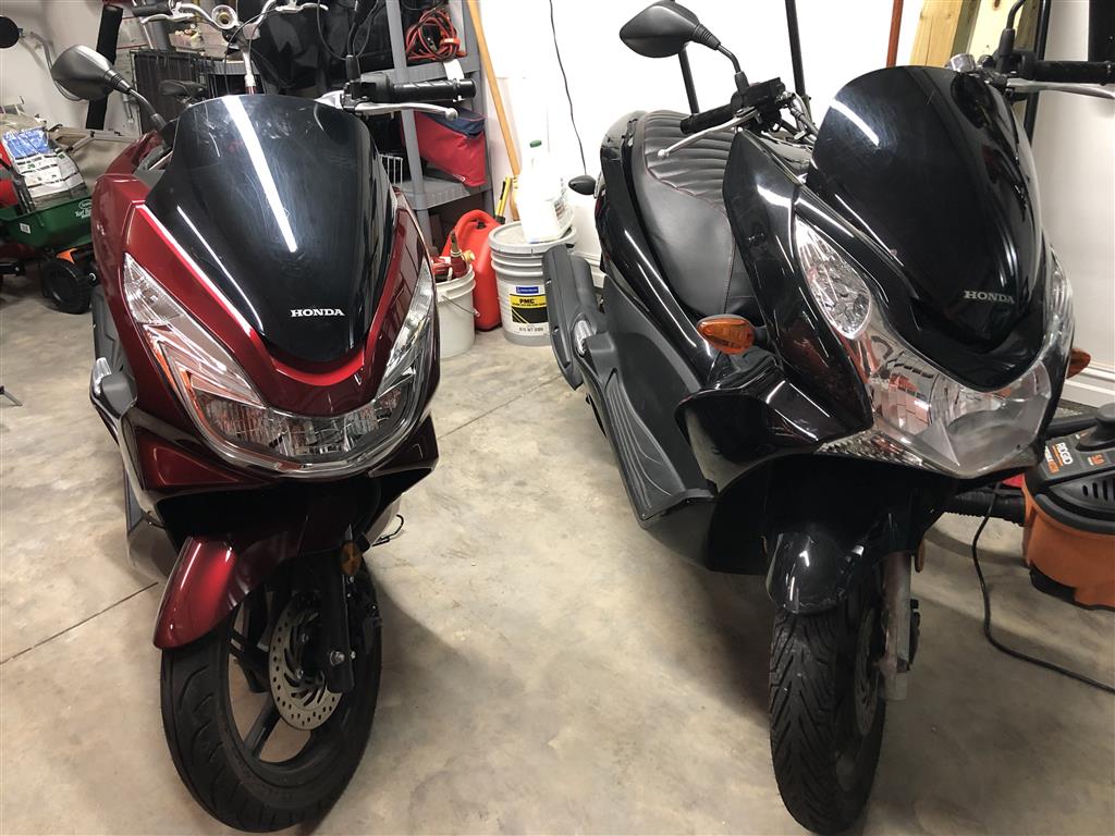

Here's a look at the difference in how they look from the front. Mine is a 2013 and DW's is a 2016 (same as 2015)
bikes (Medium).jpg (134.49 KiB) Viewed 8997 times
Re: Differences between model years Honda PCX 150
Two up front things to know, which will help you BEFORE you go through the search process:
1. The 2015 model with LED headlights has a completely different wiring diagram than the 2013 model.
2. The engine on the 2013 and 2015 models "MAY" be the same, but the frames are not. The ECU for each is different as well.
