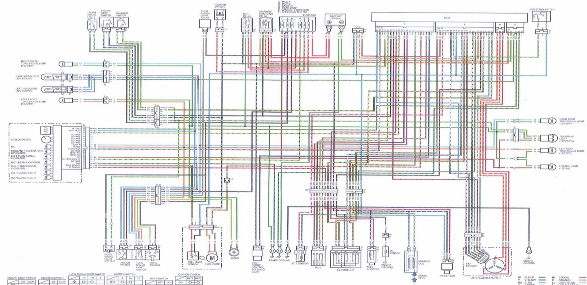

This is the diagram I’m currently using
PCX150 with 44 miles
Replaced battery back in February and it was starting fine. Was restarted every couple weeks til late March and then it wouldn’t start
Fuel gauge shows full and flashes .....Also the fuel pump doesn’t cycle on key up
I can spray carb cleaner into the inlet and can make it run as long as I keep straying
I checked for power on the two fuel pump wires and the test light is lit on both black and the brown. I do hear a humming coming from behind the airbox briefly upon keying up
Is there a way to throw pos and ground to this fuel pump and have it run continuously or is this pump designed to be pulsed through the ecm and not able to run on by its self
Trying to determine if the ecm is faulty or if the pump is bad or if there’s a relay that I’m missing to check.
Thanks in advance

Fuel pump won’t run to prime with initial key on. Wire diagram shows brown wire going directly to ecm and the black the power on the ignition switch. Key on it has power to the black wire and also to the brown so I know the pump circuit isn’t fried. But during cranking the brown wire loses power and I was hoping to see pulsing but I don’t see that. Still guessing ecm

To diagnose fuel pump, I would follow the repair manual procedures, it's hard to guess by looking at diagram and very few if anyone would be able to tell you the diagnostic procedures by memory or knowledge alone.
