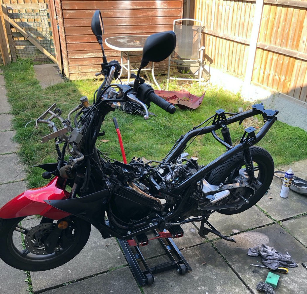

Hi I decided to register after coming across this website loads when googling certain things about the PCX....
I actually have two PCX's one red and one Black the black one is new having had just 3000 miles on the clock and the red one has just under 50.000.
My partner does delivery driving so that just clocks up the milage and I just gave her my new black one as she uses it more.
After swapping bikes I could not believe she has been driving it for so long without complaining.

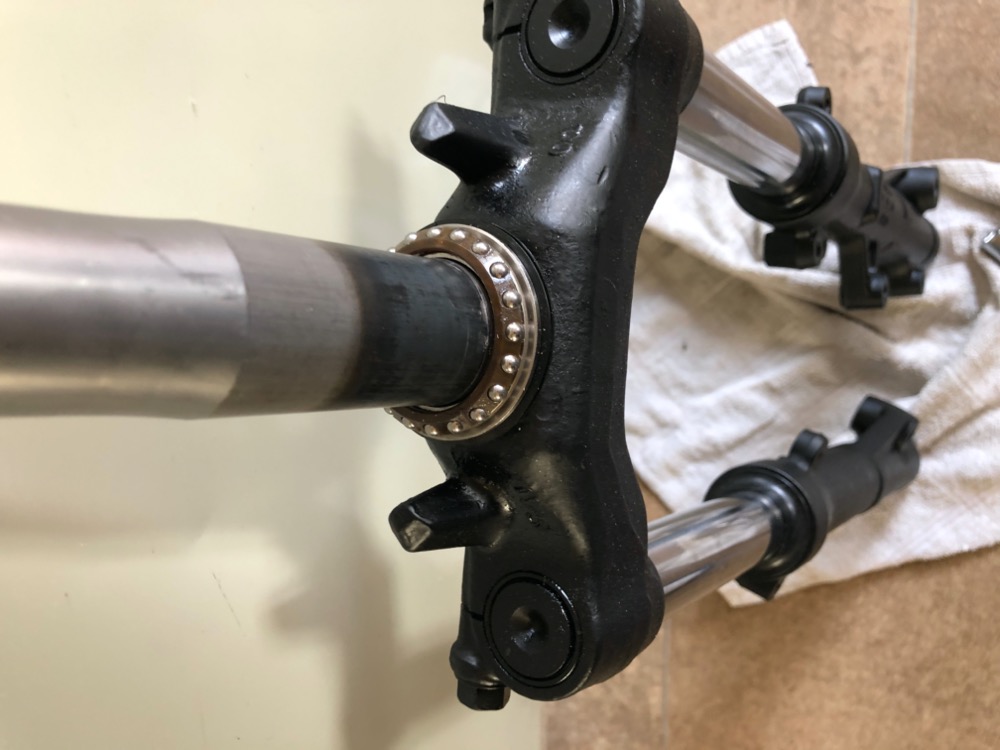

The steering on the bike seemed to be all off... She had had two minor accidents with that bike but it went to the garage after and I assumed it was all fixed.

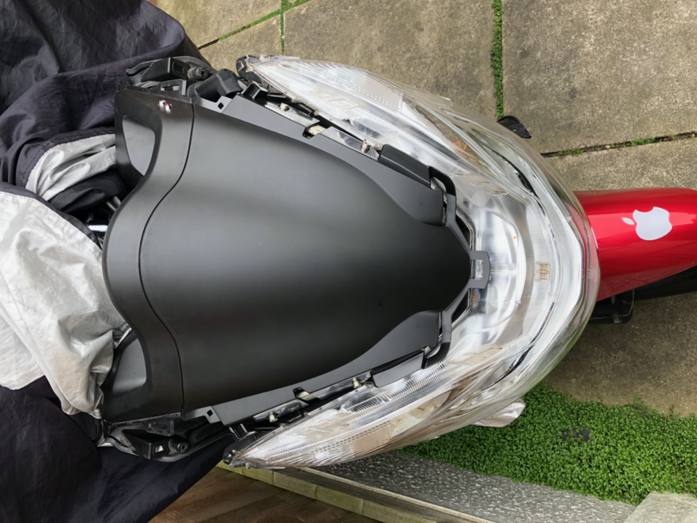

I decided to take the bike apart and to my shock and horror the yoke/fork was bent, and the light cockpit frame was all bent and the garage had used cable ties to hold the front light in place with all the screw holes broken in it...
Anyway I ordered all the parts and decided to give it a good overhaul and clean after 50.000 as well.
Tomorrow I will do a valve clearance and so far the break pads wheel bearings, have been replaced.
I've ordered all the parts in so the front fork, bracket headlight will be replaced as well. In the Black new PCX I have a polini 9 roller variater and a polini adjustable clutch so the clutch from that one will go into this pcx with white 2000 rpm clutch springs a malossi contra spring and a malossi multivar 2000 with 10 gram rollers... Well so far for my introduction please find an attachment of the progress of the bike so far..

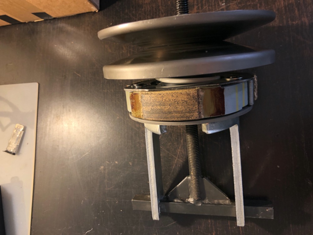

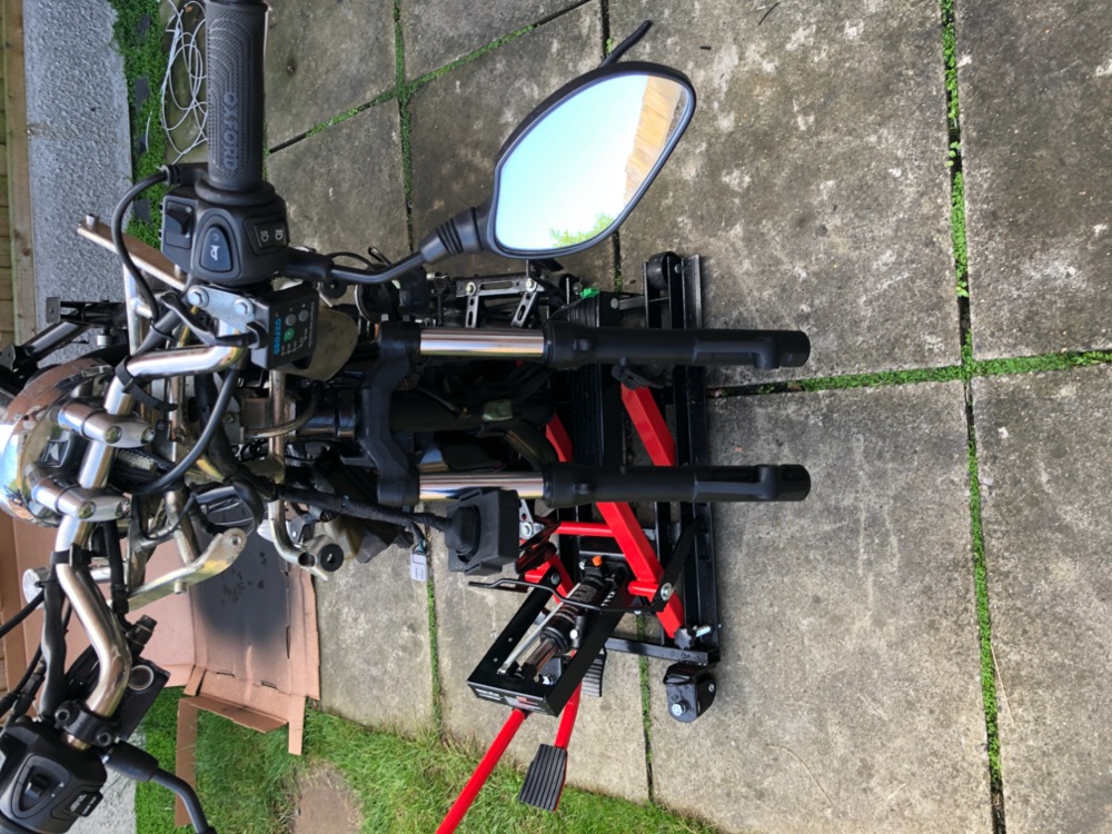

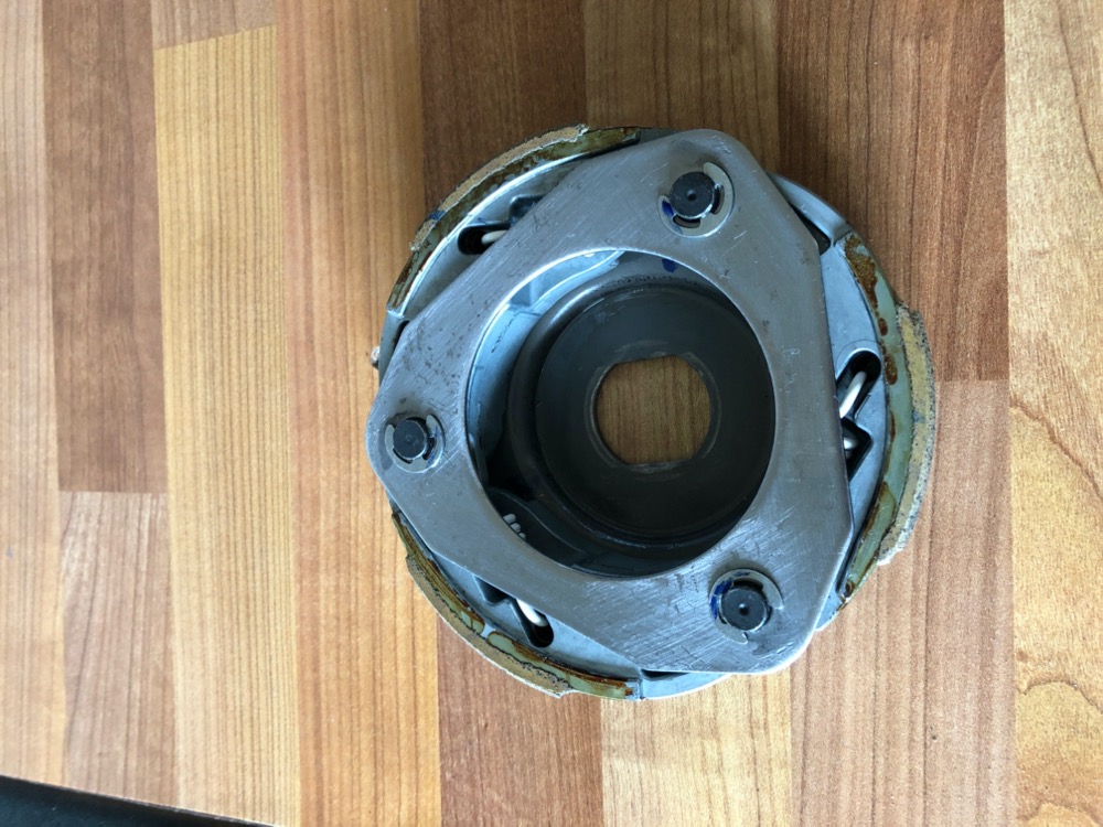

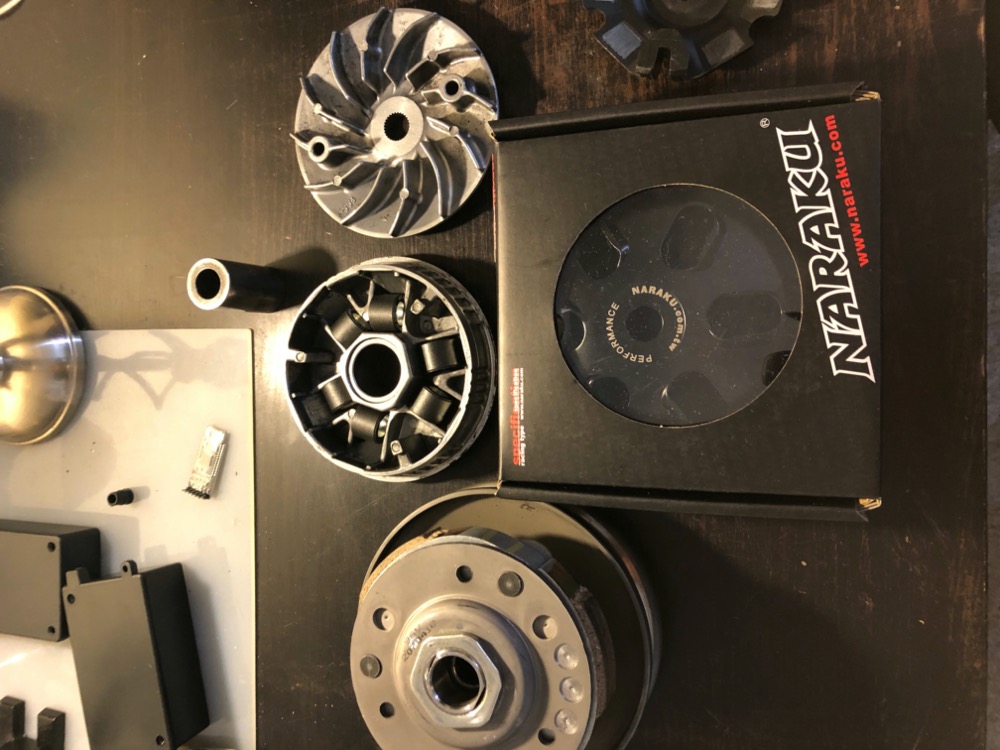

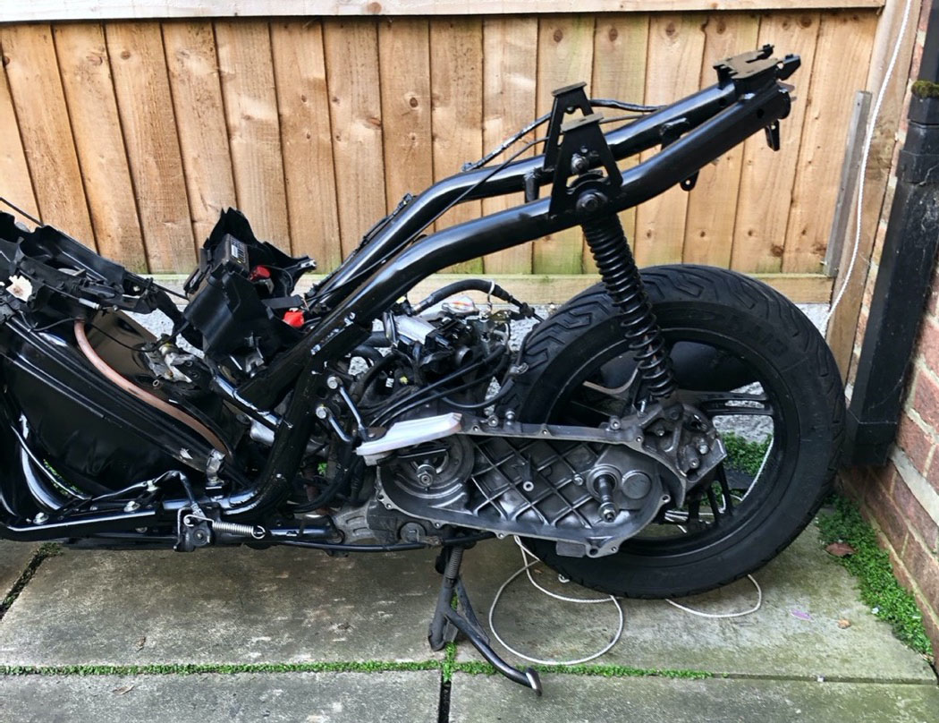

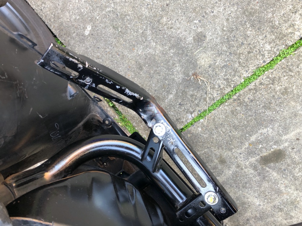

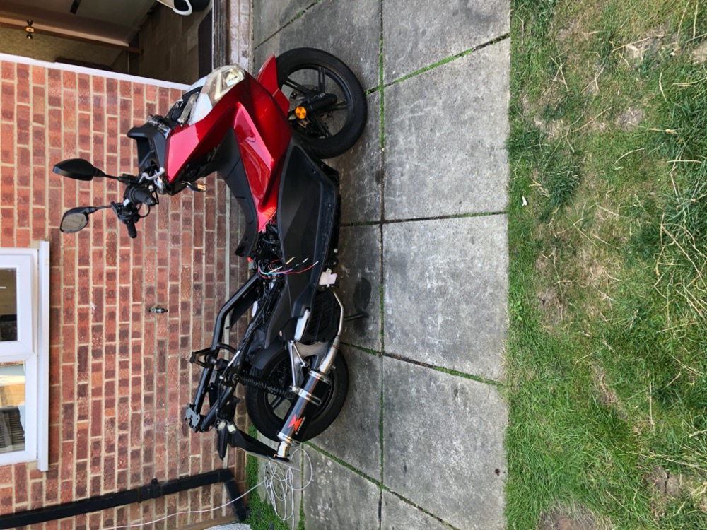

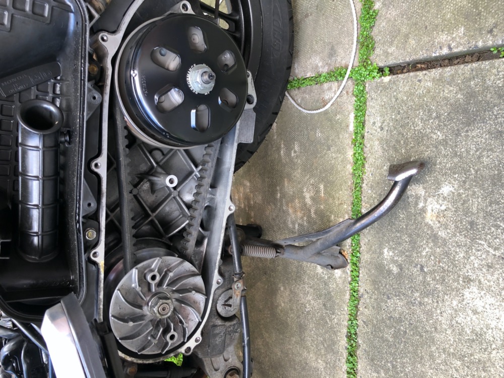

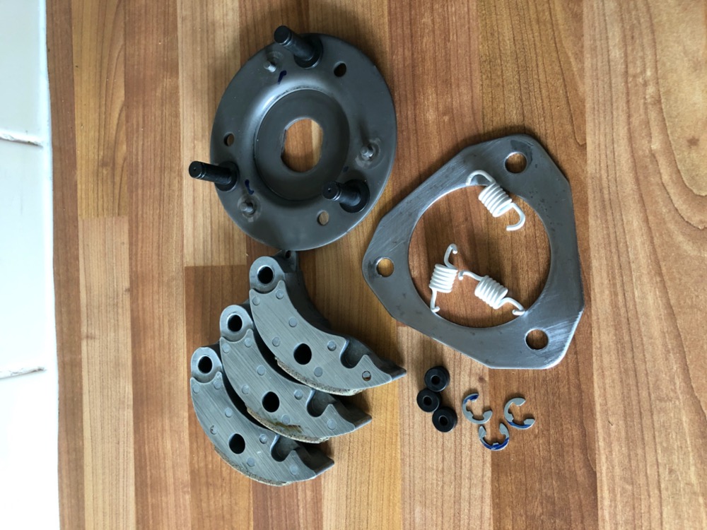

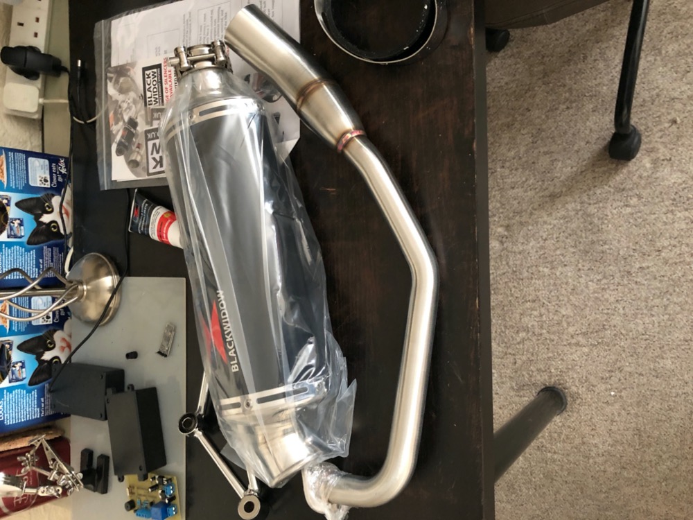

OK So here is my update as mentioned above... first of all let me stress that in the UK and the rest of Europe there are different rules restricting you to drive 150cc motorbikes without a full motorcycle license. The maximum you can drive in the UK is 125cc with a compulsory basic training certificate and a red L plate on the bike. Anything above that you'll need to take a full driving test for both theory and practical - very costly and time consuming. The reason I'm telling you this is because all the pictures that are shown here are for the 125cc model (the 150 is not relevant in Europe as such so certain things may vary).
After my original post I have pretty much done everything and the bike is almost back together. The engine is working.
I first removed the front (Headlight) frame that was completely bent and unusable and replaced it. I took the fork and yoke out after I took off the steering and put the new head sport bearings in with grease and placed the refurbed fork and yoke in there. After that I fitted a second hand headlight with all the plastic in tact and screw holes and used bolts again to fasten it the way its supposed to. After this I cut the kill switch wire from the side stand and made an electronic bypass and put a new wire in to go under the seat and wired new light next to the alarm light inside the cockpit. The reason for the last bit is that we have a serious problem with bike theft in the UK including armed bike thefts and robberies so I decided to make a little IOT kill switch project out of it and already wired the bike so I can install my own tracking device later under the seat when done. Anyway back to the bike repair. I noticed that the plastic on the right foot rest did not want to lineup as supposed to and noticed that the frame was bent and damaged so I ordered that in and replaced that as well. For the mechanical part I fitted the clutch and variator drive belt and new clutch bell. I did so many things basically that my whole explanation becomes a bit of a jumping from one thing to the next - a jibber jabber episode, but the bottom line is that all broken parts have been fixed. Parts have been improved where possible and service has been done where necessary...And I almost forgot, I found the exhaust looking a bit like a rusty pipe in comparison to all the work I had done and how clean the bike looked so I upgraded that as well. Let me just post some picture and see what you guys think. The last pictures are recent. I'm waiting for plastic to finish the bike off. Pat
Clutch Apart new springs
Clutch together
Footrest damage
Fork refurbed and painted with new sport bearings
New fork in
Has to be done
Wiring
Clutch Spring install
New Stuff
Drive in place
Exhaust
Bike now
Bike now....

WHAT A LOT OF WORK! Very nice job. It appears that you are working outside - doing that level of work without a garage is pretty amazing to me.
You clearly have a great grip on fixing these things. I'm sure you will have much to offer the group. Welcome aboard!
