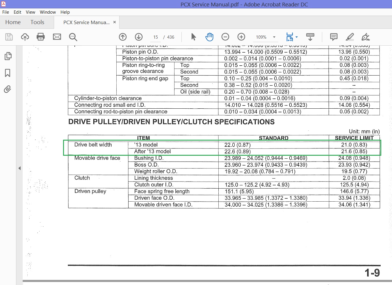

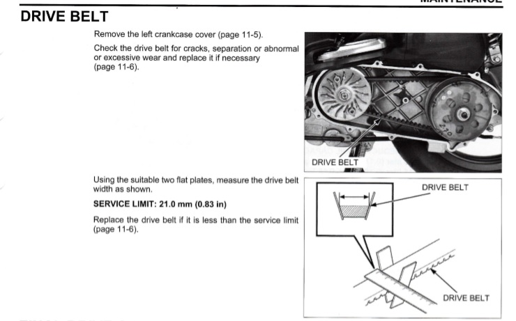

If you could post the bit in the manual which shows how to measure the belt width that would be helpful, because its not at all obvious how to do it properly.

Re: drive belt change
this from the 2013 model
Aye that's it.
