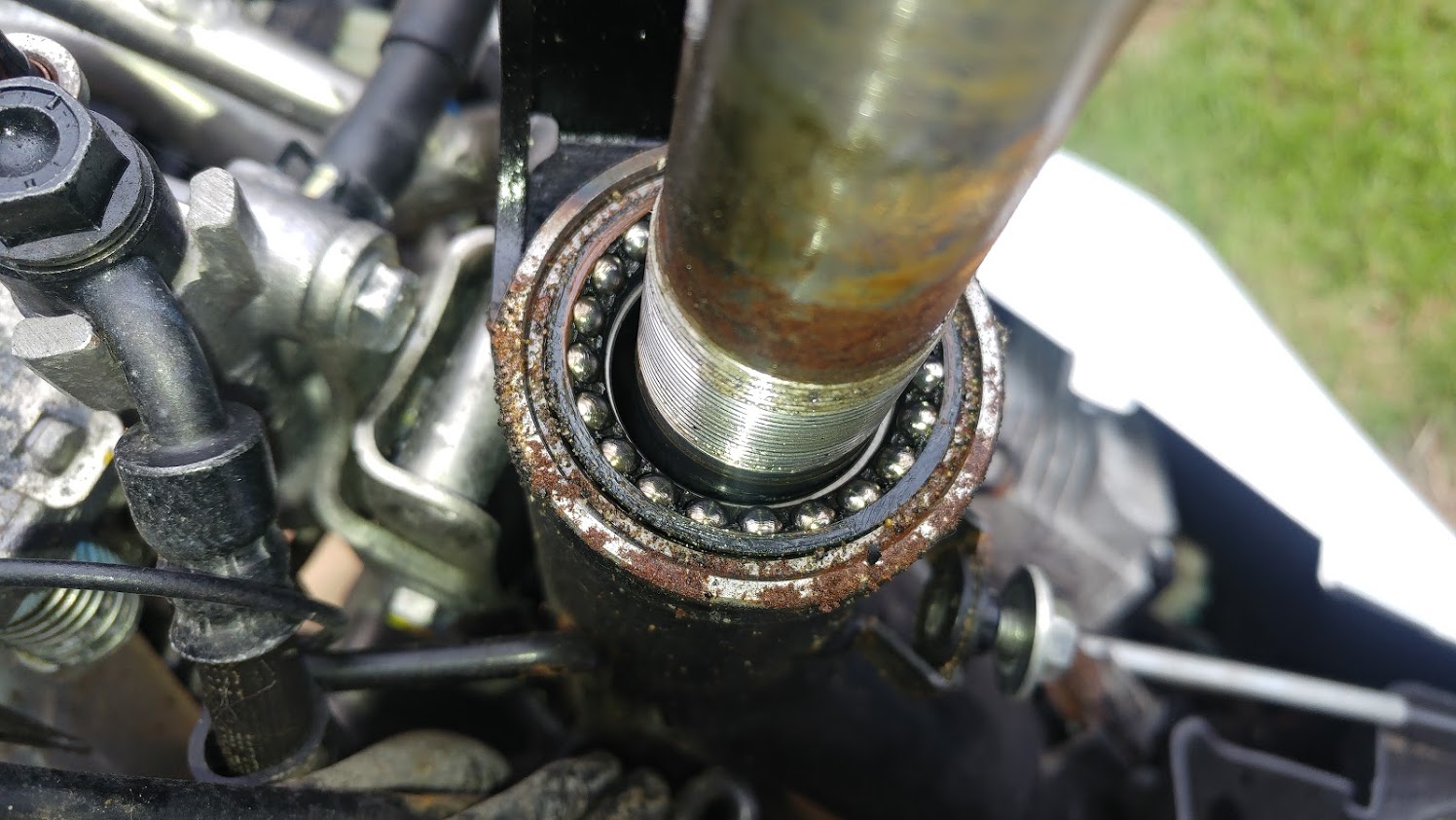

Re: Use Your Bike (at least occasionally....)
The top bearing seemed worse than the bottom. As you can see by the surrounding rust, there was not a lot of grease around.
I must say that I have never seen one in such bad shape. Do you have acid rain or something similar?
Also, if you cover a bike in a moist climate (foggy, damp, drizzling) moisture will rise up from the ground and condense under the cover. There is no breeze to dry it out, so the moisture just sits there. You should probably try to find a way to give the bike a chance to dry out occasionally. I have a tarp over my lawn tractor that I have to remove ever so often to let the breeze dry out any condensation. The same applies for the bike. Even a "lean-to" made from a tarp attached to a garden shed wall leaves room for air.
Remember, ACF-50 is your best friend in damp climates.
Mel46 wrote:I must say that I have never seen one in such bad shape. Do you have acid rain or something similar?
It’s the most minor salt corrosion not acid rain ffs.
I doubt if the bearings were “notched” from standing.
Greasing the race and reassembly would have been worth a go.
Notched bearings is a sign of impact damage and is almost inevitable.
Aquatex covers are not waterproof.
Any bike left outside in the UK needs to be fully treated with ACF 50 or it will rot.
