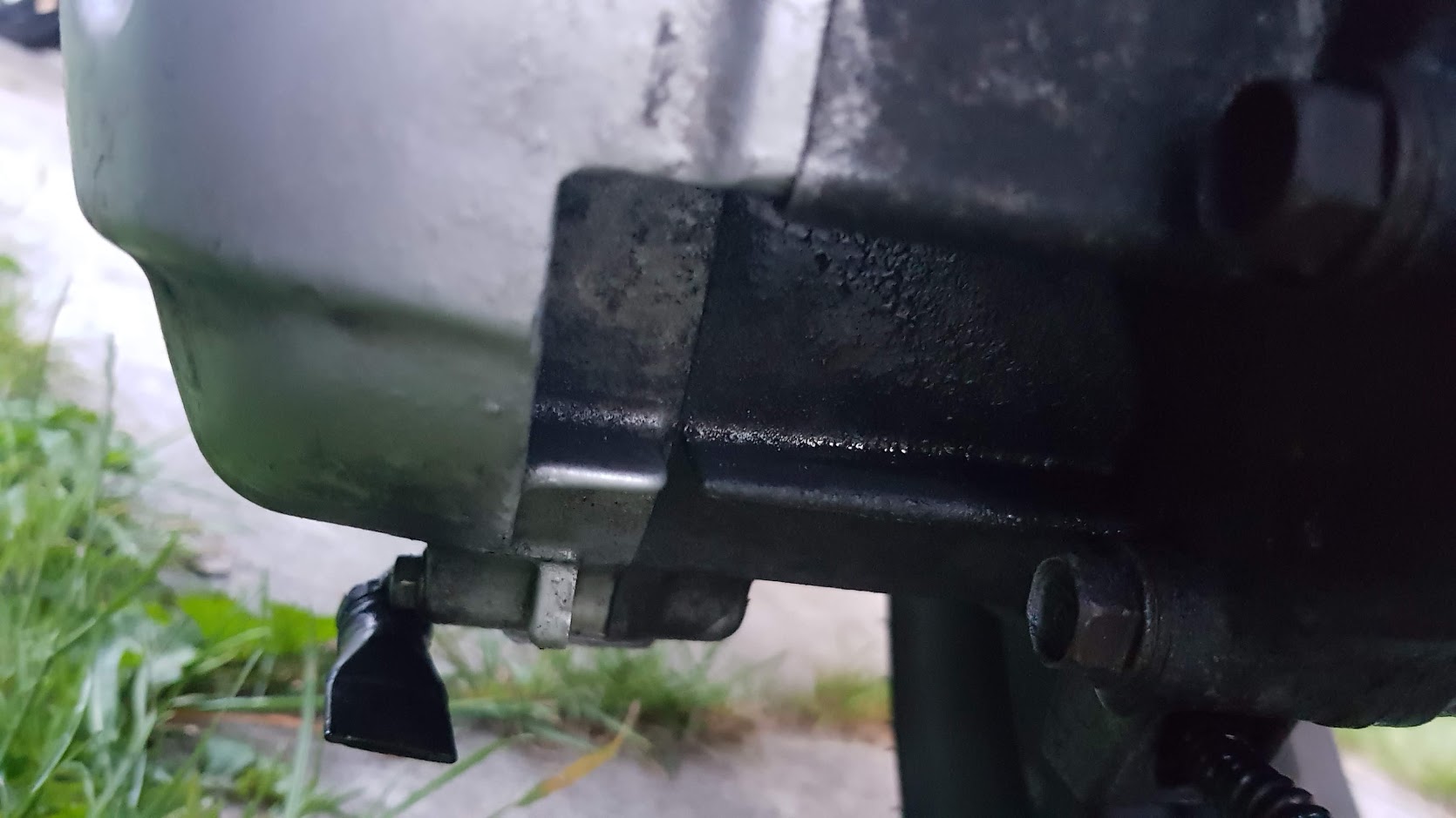

got a issue gearbox oil leaking out of the weird place
Post by accyuklad »
I just noticed today theres oil splatted on rear wheel and rear hub so I wiped it and after 2miles its dripping out but cant really tell where but heres a picture its leaking from above the tranny case hole
im pulley casing off tomorrow to find out where exactly its coming from because last time I pulled it there was no sign of leaking when I replaced belt etc 3month ago roughly
2010 pcx 125

Re: got a issue gearbox oil leaking out of the weird place
Post by accyuklad »
im just hoping its simple as a seal on the clutch side in the tranny
Post by springer1 »
Did you recently change / add oil enough that it was over-filled? If so, then this is how the breather corrects that situation & its no harm. Otherwise, could be either a bad seal or compression loss past the piston rings into the crankcase, or ? something else.
Might want to make sure your oil level isn't too high and check your air filter to make sure it's not dunked up from the mist.
Post by accyuklad »
It's coming from oil seal on rear drive shaft ordered a new one
