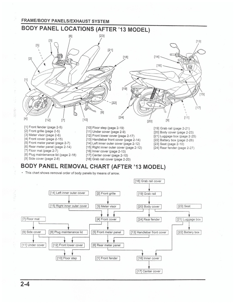

This might help. It shows what has to be removed in what order on the panels.

I presume they are from the Service Manual?

TeamTJ,
Of course. I have various .pdf versions and a full 2013 paper SM. When my last bike is sold someone will get a gold mine in options.
