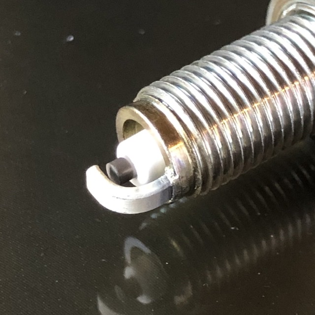

what the F “????”
1st picture- one heatrange cooler plug 10minutes (TEN)
in TEN minutes it is White metal, this thing is Spark Knocking LEAN
WHY “?”
why is this thing running Lean
All I did:
-oil change
-spark plug
-air cleaner
-cleaned out cvt air vent
-added injector cleaner
Within 24hrs of Light use, knocking..
THEN all the Friggn work and replacements..

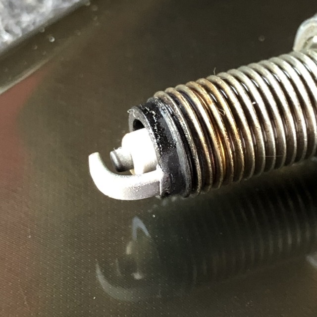

2nd picture is Original plug, notice wet oil “?”
and wetness of oil at spark plug hole
900mL is Too much oil??
WHY “?”
All I did:
-oil change
-spark plug
-air cleaner

springer1
- Posts: 787
- Year: 2018
- Color: white
- Location: SE PA
Re: 2015 PCX 150 sounds like a Rod Knock
The original plug looks either lean or a bit of bad spark timing. Correct would be grey not white, no blistering & less electrode erosion - that plug has both. The wetness isn’t necessarily oil could be rich which of course conflicts with lean. This is above my competence grade ( I stress this fact ) but the original plug’s condition IS from many miles. If faulty timing is in play, *SOME* EFI systems would sense the overheat and richen the mix which complicates the symptoms. I don’t know if the PCX would or not. But I’m not convinced that’s oil wet.
- MichaelGee
- Posts: 68
- Joined: Thu Jun 04, 2020 8:05 am
- Color: Obsidian
- Location: Lakeville, Michigan
Yes that is an old plug that was in there when I bought it, i stuck that one back in there after burning up the new plug with injector cleaner and octane booster, page 2 or 3.. darn thing was orange..
Everything was smooth and quiet for the 1st 5 days of zipping around subdivision and a couple 50mph runs to store a mile away.. Then i changed oil plug air cleaner, added injector cleaner and all Hell broke loose..
The white on them plugs is Lean Hot Detonation
Knocking happens only at even road speeds above 15mph
it’s severe enough to do that to a new spark plug in 10 minutes, with short knock cycles as sub speed is 15mph around here.. That’s Severe spark knocking..
Crank bearings and rod completely ruled out with all that I’ve done..
Which is a Good Thing but, now I’m burning up my piston, rings, and valves “?”
What the Hell..
What the Hell..

If you think its lean, Instead of buying an O2 sensor maybe buy a wide band. We used a Sniffer to tune our 50cc Carb Honda Engines.
I run open intake and exhaust with stock ECU and dont get knock. Judging by your old plug, the white ceramic should be brown. You dont really pay attention to the electrode.

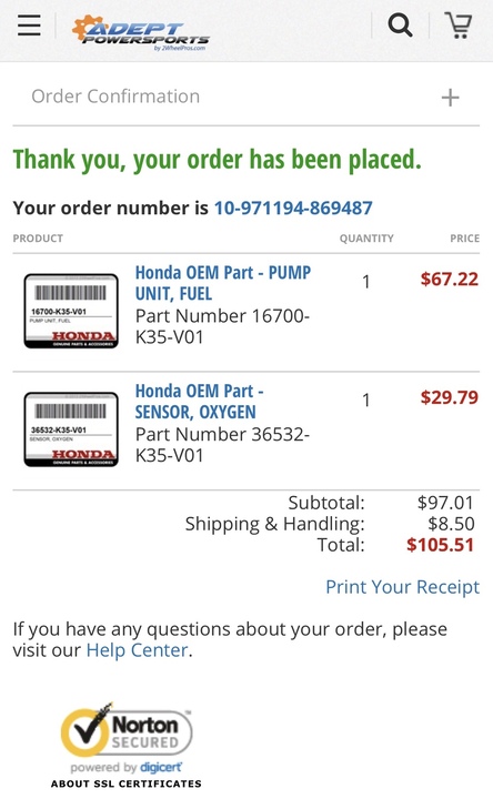

So my Brother Steve, also thinks I’m logically on the right track and Donated to the cause..
New fuel pump assembly And o2 sensor ordered at 11pm last night..
He said Throw the o2 sensor in there too for shits n giggles..
Thank you Brother Steve
Holy Crap am i Thankful..
Big shout-out to Brother Steve.. “For Youuu”
and then, what’s the 1st thing fuel injector cleaner hits?
The trash in the tank and filter, starts breaking down the trash
Tank drain to get additives outta there- fuel was Cloudy Yellow, and smelled funny.. Fuel was Not Clear as it should’ve been.. (page 2 or 3)
Remember all the grass plugging up cvt air vent and sticks jammed into center stand? it’s been Stolen, running around from the cops in fields Without a Gas cap and ignition lock switch
Maybe it was already partially plugged up and additives just finished plugging it up, injector cleaner finally did it in for minimal fuel requirements at even keel..
Sure it’ll pump fuel under Load and idle, but not Enough at even keel road speed that requires minimal consistent fuel stream.. pump straining all the time.. also explains 75% throttle, already maxed out fuel pump flow at 75% a physical fault..
Now does that Make Sense..?

Shout out to Old GrinnerOld Grinner wrote:The knock is either metal on metal or from detonation. I'm still wondering about a faulty fuel pump. With the additives perhaps something was effected? The Forza models had problems with deformation (swelling) of the fuel pump inlet cover (resin material) causing interference with the impeller. There was a "Recall" that Honda posted to make good on the deal. Ethanol does strange things to some kinds of plastic.
Guess with my anxious demeanor, i passed right over this post..
Funny how i came across this Resin info, and it was already posted in this thread..
Still waiting on Adept Powersports to actually Ship the stuff to me..
Really didn’t want to drive back out to Lapeer, ever again..
Sure hope it is this..
Hopefully this will also cure the 75% usable throttle problem too
But, it does sound this way with reasoning..
