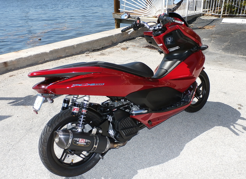

I fabricated the fender eliminator from scrap aluminum, several pieces, cut, filed, painted then riveted together. The license plate frame has built in LED light at the top, you can just make out the LED's in the pics, so you can kiss the stocker goodbye and lift the plate still higher. I have since aquired LED turn signals, the ones in the pic are OEM. I also painted the rear light red translucent but you'd never know it..pics coming soon.

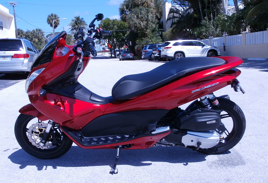

Well I finally got around to istalling the ADIO 110mm stretch kit, which I'm glad to say is a very well constructed kit, made in Japan, and built like a tank. The rear brake cable was able to reach, as was the fuel hose, throttle cable, and various wiring, some re-routing was necessary but easy enough once the bodywork is off. The home brewed fender eliminator/undertail had to be extended out 2 1/2" and re-angled slightly to look right. I think a 110mm stretch is probably the maximum because of the wiring from the ECU, unless you went about lengthening it. Personally I feel that longer kits may look good but the advantages may likely start to be overcome by negatives. One huge advantage is the much smoother ride, bumps that were annoying before are tackled much better now, even the fork has benefited although I feel I had perhaps 1/2 turn too much that I had on the PDD valves the change in geometry (rider position in relation to wheelbase) has now corrected. I dont percieve any loss of nimbleness and the bike if anything tracks and handles better than before. On the negative side you will have to trim the stowage box down to allow suspension travel, you lose about 1 1/2" right were the toolkit stows, next job is to create a bottom for the piece I cut out and removed. Right now some steel mesh is temporarily covering the hole. Anyways, another mod completed and pictured for your perusal. I really do like the look, the quality of the parts and the thought that went into the design, the ride height, shock angle is maintained, both stands work and the better ride and handling especially at higher speeds..Recommended.

That's pretty fancy Frank. Was the cutaway in the seat bucket to clear the throttle body?

Yeah primarily. The stowage bin wouldnt seat on its mounts until I had removed some of the bottom near the tool kit holder, removed about 1, 1/2" from the bottom of the bin in that area to clear and allow for suspension movement. Been to Miami and back twice since and no contact is being made. Just have to fab a patch now, I might tackle it tomorrow.chicaboo wrote:That's pretty fancy Frank. Was the cutaway in the seat bucket to clear the throttle body?
