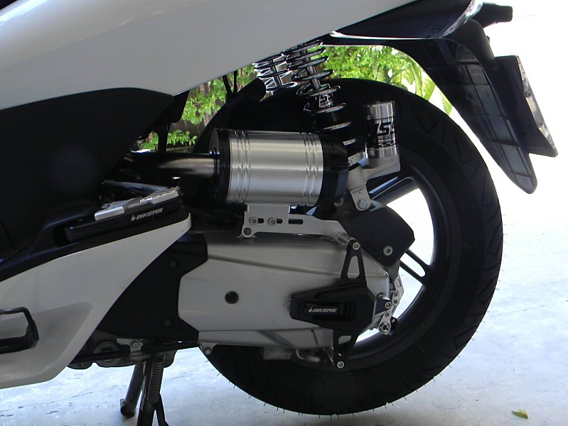

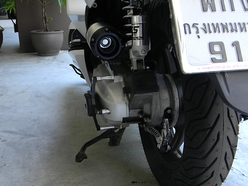

This sounds and works sweet too.
PCX Canister Breather 02.jpg (91.99 KiB) Viewed 12903 times
PCX Canister Breather 01.jpg (100.73 KiB) Viewed 12903 times

kramnala58 wrote:This sounds and works sweet too.
I love the sound of this one. How the PCX a is supposed to sound IMHO ..... Covers up the Ricky ticky noise. What gram rollers are you on. I love the 12gram with this air filters. Also is your adjustable.
