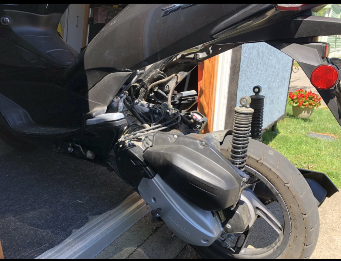

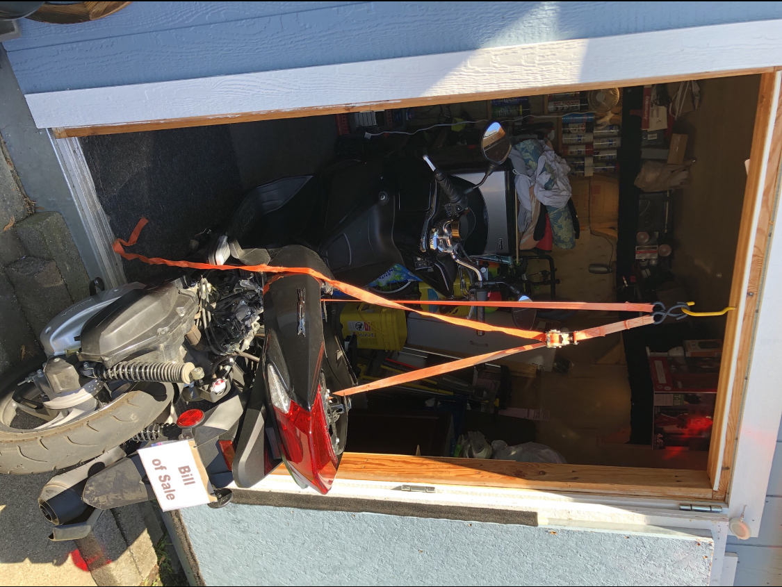

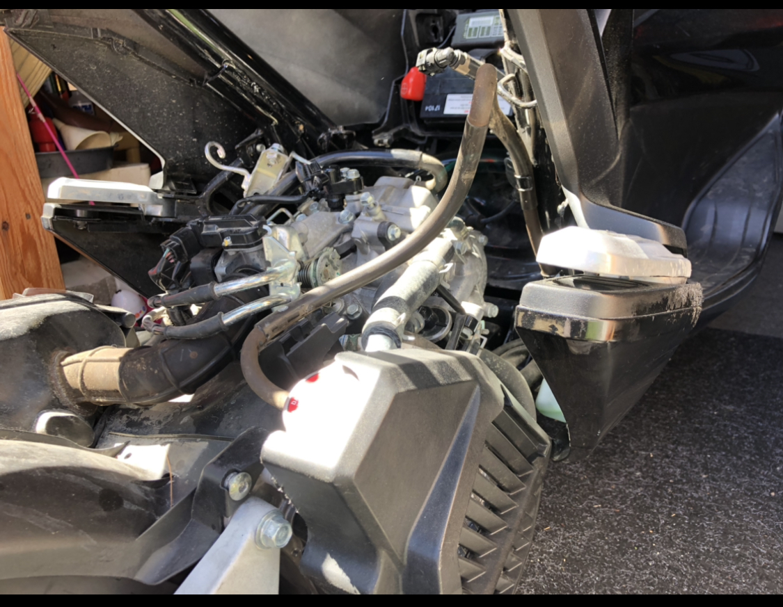

Thee Smart Way to do Valve Adjustments
Whoever follows the manual to adjust the valves is Wasting their time..
14 procedures to Get Too the valves, is so stupid.. Honda
So here’s my way.. said it on page 1
Pull seat n box out, disconnect fuel n vacuum lines, unhook coolant line, strap frame to hang, drop the shocks, cylinder head swings Right into view..
Boom ready to do the valves, in 20minutes.. don’t even touch battery and battery box, Tons of room..
- 404EDFE9-3384-43F7-A4F6-E946AA4B3B0E.jpeg (874.37 KiB) Viewed 6380 times
- 6E6FD156-AD93-4A13-87A7-EBE4D17E8949.jpeg (858.91 KiB) Viewed 6380 times
- B2A3DAB7-AF7E-497A-BA07-6288239D37F4.jpeg (1015.86 KiB) Viewed 6380 times
