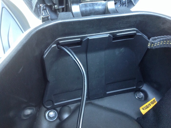

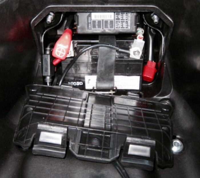

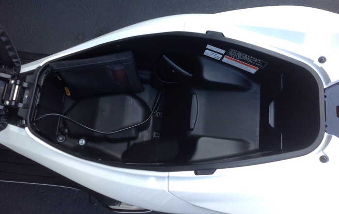

I can help you with one of your questions. I did use the eyelet connector's, they're placed on the batteries + (positive) and - (negative) terminals. You can see a bit of that here:
I then placed that small wire through an opening in the top left of the batteries cover. That makes it easily accessible under my seat.
In my case, I did have to buy the optional extension wire because my electrical outlet is a distance away. That longer extension connects directly into the smaller one and then...Viola! I have Tender Power
Btw, my seat is closed while my battery is being "tendered." I ran the shorter wire through an open space found on the right side of the seat (near the seats latch). It then hangs outside the bike. This is where my extension wire gets connected.

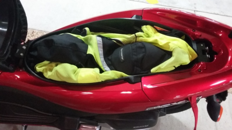

I found a place to stash my air pump. First, I took my pump apart. I then got a big enough ziplock to put the pump in and stashed in in the front fairing of the scoot. Pictures might be a better description. I'll be wrapping the pump in a sheet of foam so that it won't rip through the ziplock bag.
