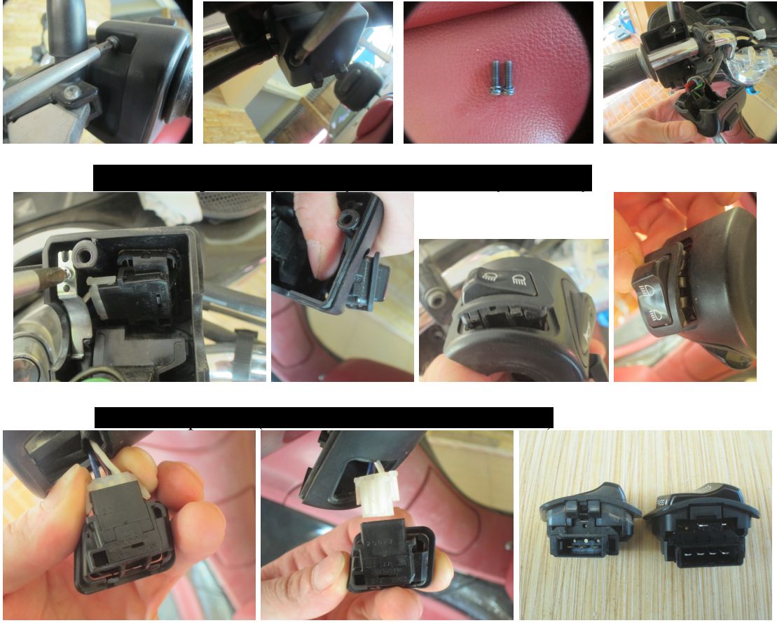

1. spring loadedhomie wrote: 1. Is the toggle action spring loaded or click lock?
2. Auto Flashing or manual?
3. Can switch be pulled out, removed and rewired without opening the control unit?
2. Manual
3. Unfortunately not, in the control unit the cables are fastened inside with a clip, so the cables fall out shorter around the switch. To disassemble the control unit is uncomplicated.

In the picture no. 5 is this clip, which must be made loose.

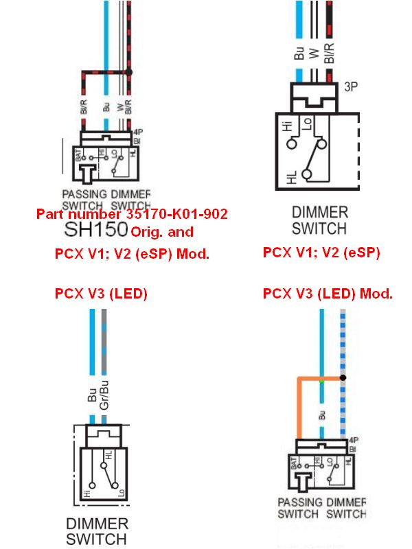

And have still made a picture with connection differences between SH and Pcx models + modification.
