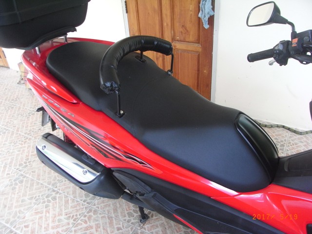

Hello Linnets and others I bought my Forza 2013 and i like it for longer trips 5 month ago i bought a pcx150 2013 and I love it so I do not use my Forza very often any way I made a backrest for my Forza so now I can drive it hours with no problem with my back and ass
- RIMG0873-640x640.JPG (71.27 KiB) Viewed 2735 times
