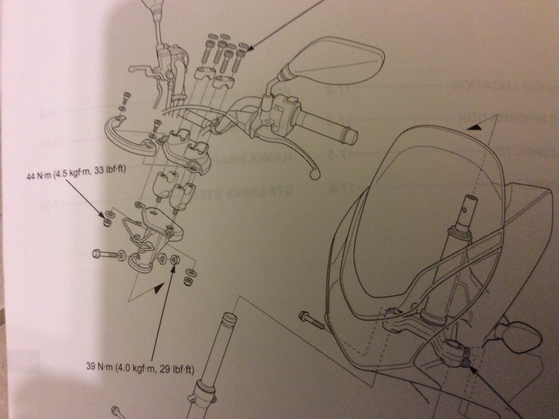

Well whadaya know, Honda doesn't use the typical setup here. Huh. That's interesting. There is a bolt that holds the steering stem in place rather than a collar and locknut. There is a nut on the bolt of course, so there's that.Ishkabibble wrote:Homkerman wrote something a few posts back that won't get out of my head.
As I've said before, I dont' do humor on forums, and so I don't know whether or not there really is any such thing as a nut under the handlebar head.honkerman wrote:[There is definitely a steering head nut though.
The service manual seems to me to be fairly inconclusive, meaning that I don't have the physical scoot here in my presence to compare it to the little drawing in the book.
Can someone give me a straight answer without any attempts to crack jokes (if this is a joke)?
The steering stems I've taken apart (only a few admittedly) do have the traditional setup. I'm not sure I like Honda's design here. It seems weaker than the traditional setup.
The nut and bolt in question are on the left side of the photo.
I wasn't joking exactly, I was chuckling because the steering head needs to be secured in some way. I never bothered to check the manual to see that it wasn't the traditional way.
