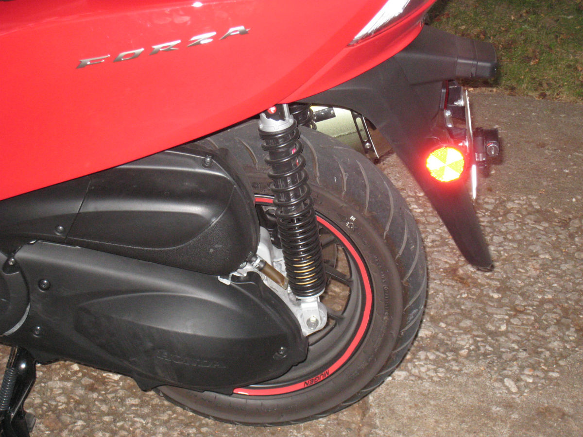

Branyers14
Posts: 84
Joined: Mon Aug 03, 2015 4:17 pm
Year: 2014 Forza
Location: Hannibal, MO
Re: Malossi Shocks
Post by Branyers14 »
Another angle as requested.
