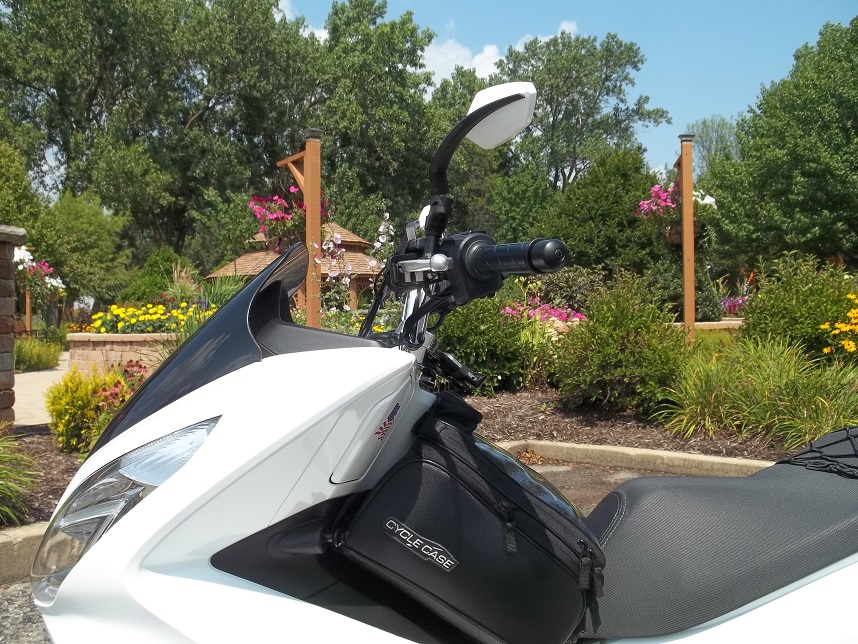

I have never had my handlebar, column, instrument gauge area wet white noise, perhaps that's why mine came loose. Don't give up, just look at how perky :lol:
bars up.JPG (379.86 KiB) Viewed 2898 times
Re: Cosmetic cap removal....
Be-u-tif-ful! Damn, you are an inspiration :D Get-on over here and do it muscles! :lol:

I did in fact order, receive and use the hex head mm sockets on my ratchet ...."After" giving the 4 bolts an overnight dose of the "Blaster PB" (pics are above).

So your bars are up? Perky
How do you like the look and feel? I'm never going back to factory position.
Yep, perky sir and I be one happier rider. Family/friends call me orangutan arms all my life (Nice folks) :D
Anywho, what a difference! I feel more in control. WN listens so much better now. No more bickering with each other. I turn, she goes! Yeah baby! We're a couple!
(Now I want to find a larger screen that works with my bars fully forward (up). The brake levers were hitting my new Givi medium height screen. I removed the screen and sold it to a Very nice forum member (Brent). Stock screen back in place). This is the downside to Full Forward (up) bars...Must try to find a screen that's shapely and compatible.
But!!! I LOVE ME PERKY.....BARS! :D
