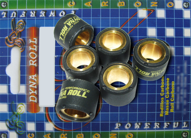

today I found also this carbon rollers in Germany 23x18 - in 15 gr and 20 gr
carbon 15 gr.jpg (189.04 KiB) Viewed 7527 times
what do you think about the quality. Are they similar to the Adige rollers?
In the mean time I'm waiting for the dr Pulley sliders, I start with this simple combination, you suggested to me last time : 3 original rollers and 3 carbon 15 gr.
After all it has left a doubt: if Carbon rollers have the good quality you spoke about....................
"........The Adige Carbon jackets are extra hard and when combined with sliders that are bearing most of the load, they should last ~50000 miles before you need to inspect or replace them....they'll outlast several belts! that's the best reason for using them, but they're also very slick and that makes them very responsive to throttle changes...that lets them sort of act like a +10% contra spring when reducing throttle...easier downshifts......."
why isn't necessary to change also the 3 original 21 grams with carbon rollers 21g same brand ?

There are several sources of carbon rollers, including Kitaco...
they should work equally well

On looking again at your friend's video carefully, what I noticed most is the tach reading (way more important than the speedometer to my eye).
Remember I told you earlier that for any given weight combination, 6 identical sliders should always give the fastest 0-60 time...
that was a good run for lightweight sliders.
for a stock Forza with 6 - 17G sliders, this is what I saw....
0-60 --- 11-12 seconds @7000
0-70 --- 17-18 seconds @7900
0-80 --- 24-25 seconds @8400
basically his 60->80 time was equal to his 0->60 time or ~12 seconds to gain that last 20mph...
I'm pretty sure that's where 3 20G sliders and 3 15G rollers will outshine him.
You should see lower rpm at each comparison point I referenced and slightly faster 0-80 time...
that's my prediction anyway! :roll:

basically his 60->80 time was equal to his 0->60 time or ~12 seconds to gain that last 20mph...I'm pretty sure that's where 3 20G sliders and 3 15G rollers will outshine him..........
Are you saying that is better time from 60 to 80 miles or also from 0 to 60 miles?
What you want to test with 24x18 sliders is a mix with 23x18?
