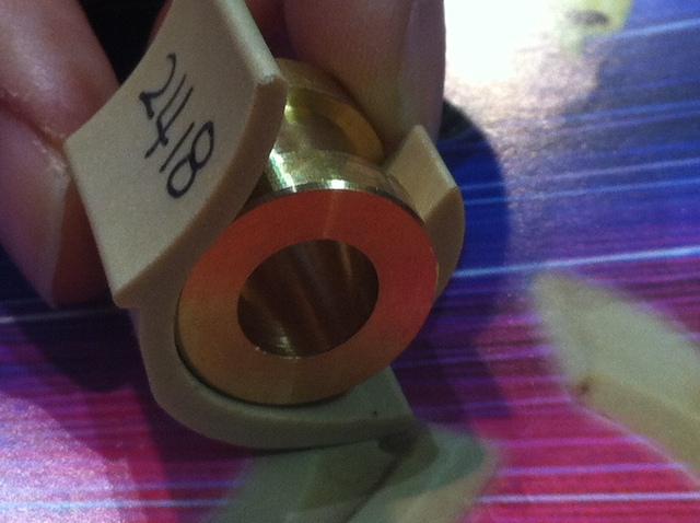

I would love to have a set of those Nuovi Rulli weights.....
the one pictured would be perfect to test since they're Helix rollers (24x18).
that means they're tall enough not to drop your starting gear, since they should be about 1mm taller than the 23x18 version
I love the cam design....it looks like it would work!
I cannot find 24x18 sliders either by DR Pulley or Nuovi Rulli in the US....
it's possible they could eliminate the need to mix in 3 rollers, but I can't say that until I've had a chance to test them.

here another pic taken at Eicma Milan (motorshow)
Robert
I'll contact by email the company that distributed dr Pulley to ask information about the new sliders. I hope to have good news for you.
Robert
- new dt pulley sliders - Eicma Milan.jpg (108.01 KiB) Viewed 7561 times

also I found some 24x18 sliders in Germany and ordered a set of 20G 2418.....
apparently the Burgman 250 uses Helix rollers!

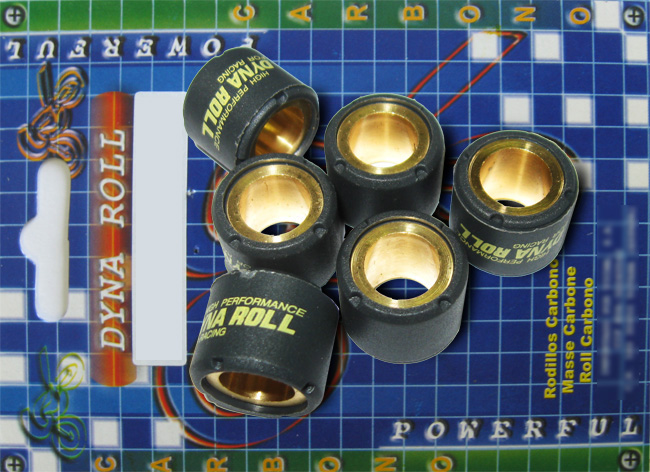

today I found also this carbon rollers in Germany 23x18 - in 15 gr and 20 gr
what do you think about the quality. Are they similar to the Adige rollers?
In the mean time I'm waiting for the dr Pulley sliders, I start with this simple combination, you suggested to me last time : 3 original rollers and 3 carbon 15 gr.
After all it has left a doubt: if Carbon rollers have the good quality you spoke about....................
"........The Adige Carbon jackets are extra hard and when combined with sliders that are bearing most of the load, they should last ~50000 miles before you need to inspect or replace them....they'll outlast several belts! that's the best reason for using them, but they're also very slick and that makes them very responsive to throttle changes...that lets them sort of act like a +10% contra spring when reducing throttle...easier downshifts......."
why isn't necessary to change also the 3 original 21 grams with carbon rollers 21g same brand ?

There are several sources of carbon rollers, including Kitaco...
they should work equally well

Robert, never mind...
this is the potential confusion with the term sliders I mentioned earlier.
I just saw the 2418 you mentioned is not 24x18 weights, but DR Pulley variator sliders....the 3 sliding bearings.
I would only use the original 3 OEM Honda sliders, since every time I've used the DR Pulley sliders, they cracked and jammed up the variator, causing it to hang in one gear while shifting....this usually happened after several hours of highway riding.
The DR Pulley sliding weights are excellent but unfortunately, their sliding bearings suck!
