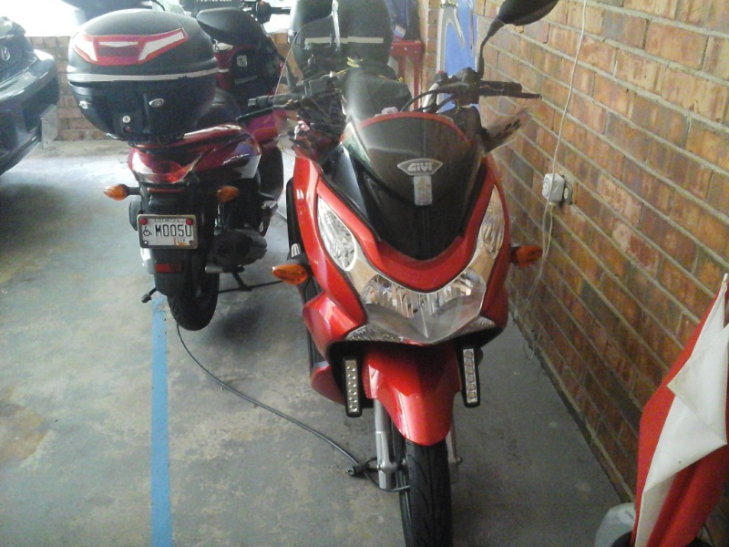

When I took my bike apart I could not figure out how to add the extra lights to the wiring harness without it being too much for the fuse. I would have had to drill out the light casing for the bottom lights and then try to find some lights that would work well but not melt the plastic. I gave up and just added external ones that I can control from the handlebar switch I also added. Here is what they look like.

Those add on LED bars make excellent daytime running lights but what kind of pattern do those throw down the road at night?

I have not used them but one time at night, and that was for a local run on streets with very little in the way of street lights. Once they were aimed properly they were excellent. I aimed the right one so that it would shine more toward the edge of the road, but not in the ditch. I wanted to be able to see curves further ahead of me. The left one has a great pattern ahead. In fact I ended up aiming it down a little more so that it would not hit oncoming traffic, just the road. I put a slightly less intense set on my wife's bike, but it works quite well too. The lights are made by Kawell.

I don't see anything tighter than 60 degrees at Kawell. This is ridiculously wide for use on the street. Perfect for lighting up the tree tops and shining in peoples eyes.
